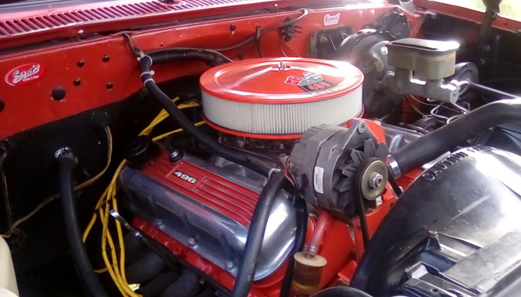

I had a 76 date coded 454 of "unknown origin". It needed some major cylinder clean up. I order a Skip White 496 complete rotating assembly. 750 holley, Wiend dual plane, 781 iron heads. Happy motor, runs great torque monster. Gets 11 mpg in K20, 3:73, SM465, 208.This is my old school 8.1!!
