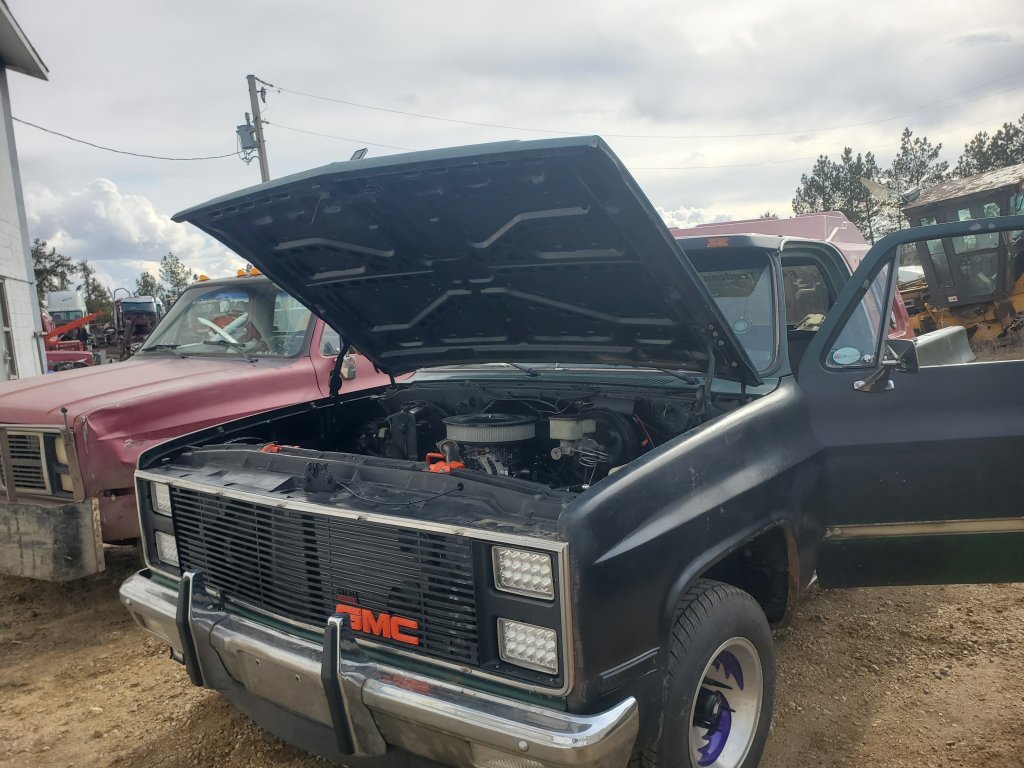

Ok, since my motor grenaded on me I am installing a stock 350 and 700r4. I have a few questions about doing the 700r4 swap. Mainly what will I need to change when installing this. I'm going from a th350 to the th700r4. The transmission and motor are out of a early 90s chevy which I am converting back to carbureted. What will be required to connect speedometer, electrical, and vacuum?
