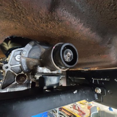

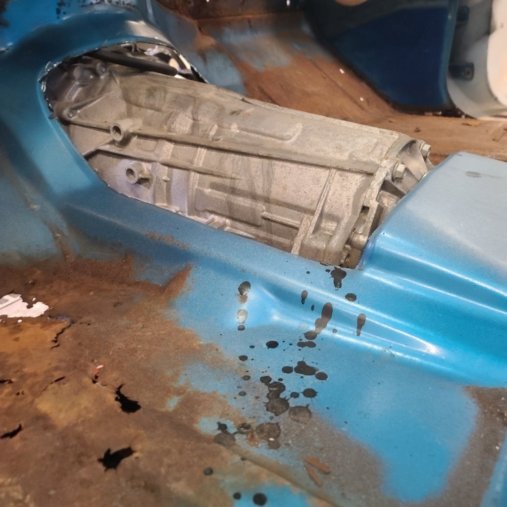

It does not fit with the 73-80 floor I can attest to that, mine is behind a LT motor with tejas mounts and so far added a 2wd high hump, not enough, will need to most likely use the 4x4 high hump to get past the seat. I am still working on a solution.

not enough room under 2wd high hump, and no clearance for the driveshaft
