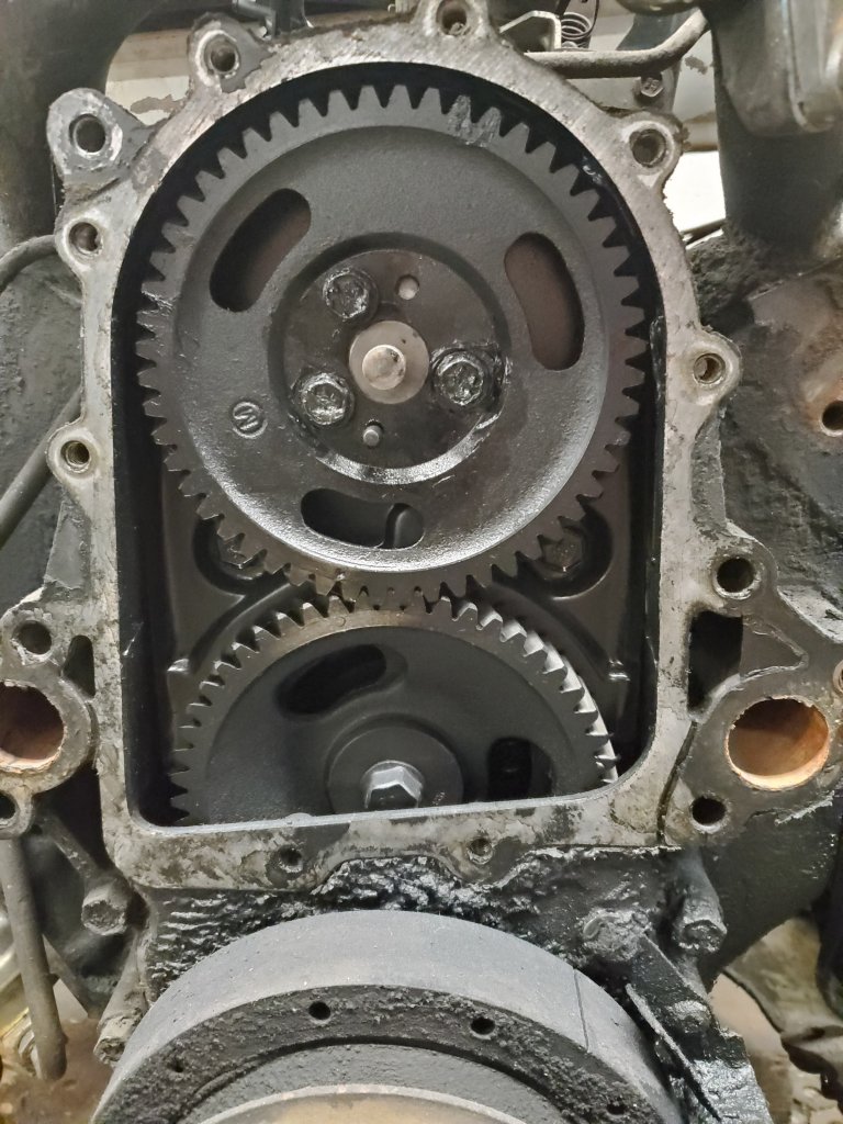

Any little roll or movement of the engine will cause this unless you remove front timing cover and find the slot, not the hole that is close to the slot, then it will be out of time. Sometimes the cam can be at right angle that when you pull the ip then the engine moves a little bit. Most people do not pull the top part of the time cover to make sure they are in the slot and not the hole that it will drop in. You can pull the oil filler neck and have sight on the slot but is the rest of the engine lined up on the timing marks. If you stabbed the IP and the slot peas there and not moved them you are good. Did you have it at TDC when you pulled IP? Did you have to move it any at all(engine) to install IP. Also did you get your line installed correctly? Going to the correct cylinder?

These Stanadyne IP's can be a real pain. There is only a couple degrees of timing that you can manipulate with these though. If you replaced the pump and didn't remove the timing cover then there should be no issue with IP timing; the gear will move in the housing but I have tried to get them to jump teeth before and cannot because there's not enough clearance in the housing. The gear will move but not out of mesh with the drive gear.
Have you gotten a replacement IP from another engine or a remanufactured unit? I've had some junk ones that you have to beg to run and then the engine runs erratic and smokes to high heaven. Look on the mount at the front of the block and see if the "0" on your pump matched the line scribed on the engine block. These pumps can be advanced and retarded just a few degrees either way; this makes starting difficult in one direction and a power decrease in the other (which you definitely don't want).
Strickland
