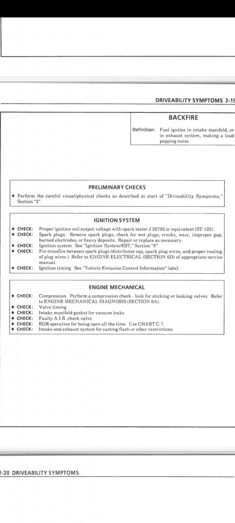

1,645
2,237
Lean, low fuel pressure think the specs are 9-13 they will not run near the lower spec, fuel volume plugged filter, have seen defective off brand distributor caps crossfire buy a Delphi they are expensive, bad coil, corroded coil tower, bad plug wires. Check vacuum if uneven suspect valve train issue ie: broken spring, flat cam, ect.
