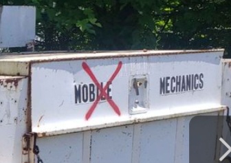

In case you want to see the whole thing!
It comes with the original bed. Not this white one

The work box body was very expensive in the day. It's the exact same body I used on the Ranch Welding.
They were used for highway road safety service trucks, for semi-truck mobile mechanics.
The rear bumper bench vice, (if it is an old school USA HD version Columbia), is probably worth a bundle.
The bucket seats are not stock. Very nice find.
I'll bet you can re-sell the box, blasted and painted with new door latches/locks, for triple whatever you paid for the truck.
Hope this helps.
