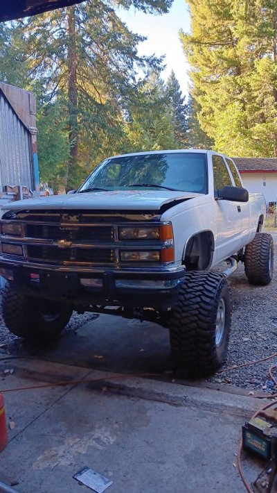

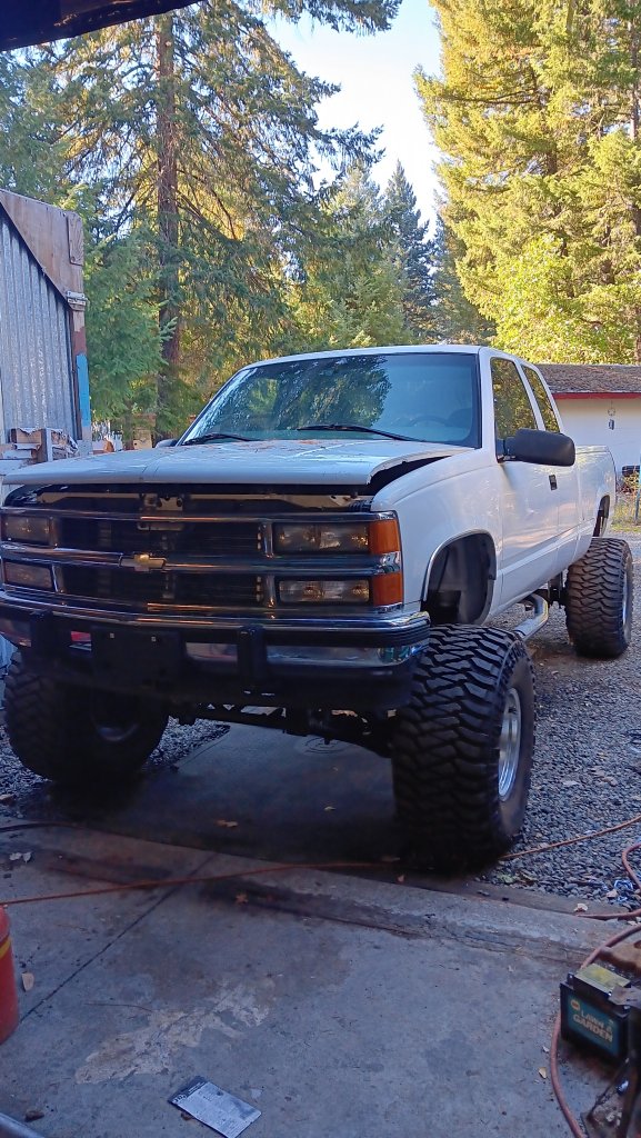

Im Helping a friend put in an engine and harness from a 95 454 into a 98 K 2500 truck. In the tank is a new fuel pump and sending unit. I'm hoping to simply replace the pump and use sending unit. My questions are
does Anyone have a part number for a good one to use? And Is it true that a little extra psi is good?If so how much is acceptable. know that the vortec pump is way too much.
And Yes. There will be pics

Truck had a ramjet 502 in it.
