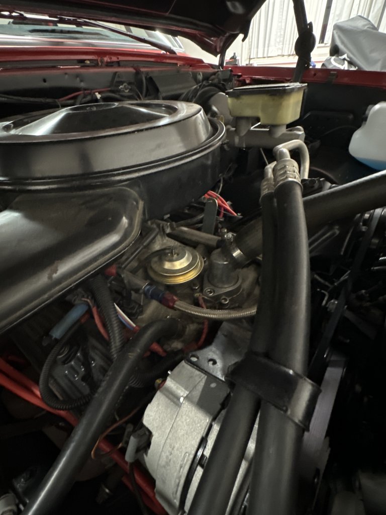

Hey all. 1987 TBI with an older Edelbrock Pro Flo FI kit on it. I took my truck out for the first time this year and noticed that once the truck is warmed up to operating temp, the engine idles low and poorly at stop signs while in drive. It idles fine in P and N but when I come to a stop sign the brake pedal shakes almost like I have some crazy cam in it. I replaced the IAC with no luck. It's interesting how this only happens when it is warm. I don't think it's a fueling issue because it only does it when warm. I have heard that when the EGR's go bad it can cause these symptoms however I am stuck. I have no codes and the service engine light has not illuminated at all. Like I said this only does it when the truck is up to temp. It starts great, idles great, and drives great under acceleration it is only at idle under load when the motor sounds choppy and like its going to die. I do not have a tach as well.
Also does i looked on the pass side back of intake and do not see an egr. Did they move them to the front with the conversion? I posted two pics below. Also there is an open vac port on what looks like a solenoid would this cause an issue? Thanks!

scanned today. No codes. Just flashed the “12”. I checked the coolant temp sensor. Should the plug be able to turn at all inside the sensor? It moves about a 1/16 of an inch.
Also my EGR if that's what is in the above pictures is a solid dome. I cant stick my fingers in there to see if it moves freely.

Odd you say idles fine in N and bad in drive? That's usually only a 2-300 RPM change.
Check EGR. Most times a finger can be used to pull up diaphragm. If not, need to use vacuum, either suck on it with an extended hose or use vacuum pump. If ok move on to other possible vacuum leak areas, intake, base gasket, ect. If vacuum gauge is available what is the reading? Low vacuum ECM will "think" it's under load and add fuel.
As previously suggested ignition is another possibility. Don't toss parts at it, shot gunning. Take diagnostic steps and eliminate items one at a time. TBI is a dependable simple system.
