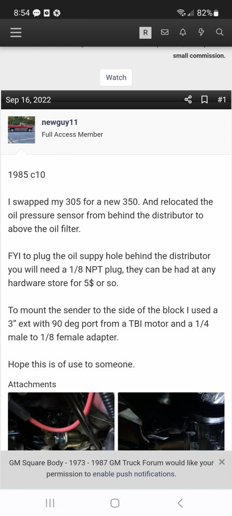

Well there seems to be some confusion,I've always seen the O.P. sender located behind the distributor,and just yesterday or so somebody wrote about how they relocated theirs from behind the distributor to the port above the oil filter,and what fittings they used. So if redfish truck came that way from the factory,then we all need to take note that they are not always behind the distributor.

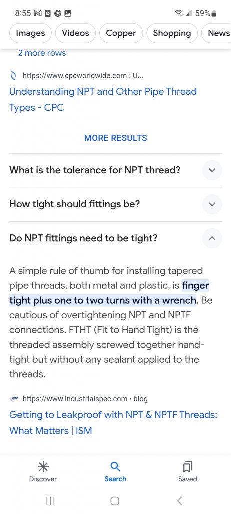

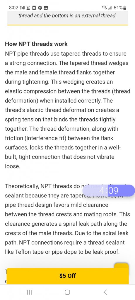

There isn't a torque spec, it's tapered that's what makes the seal. If you over tighten it that's bad, it can cause cracks. Threads should be dry, that switch has to ground through the threads. Look up national pipe thread on Google. I forget what the taper is I think it's 1 /16 inch taper per inch of thread anyway it acts like a wedge,too tight damages things. There is a spec but it's not torque,it is x number of turns past hand tight I go snug plus barely any it's a judgement call.

I found a rule of thumb spec for you better than my snug plus barely any description I gave you 2 posts back.
