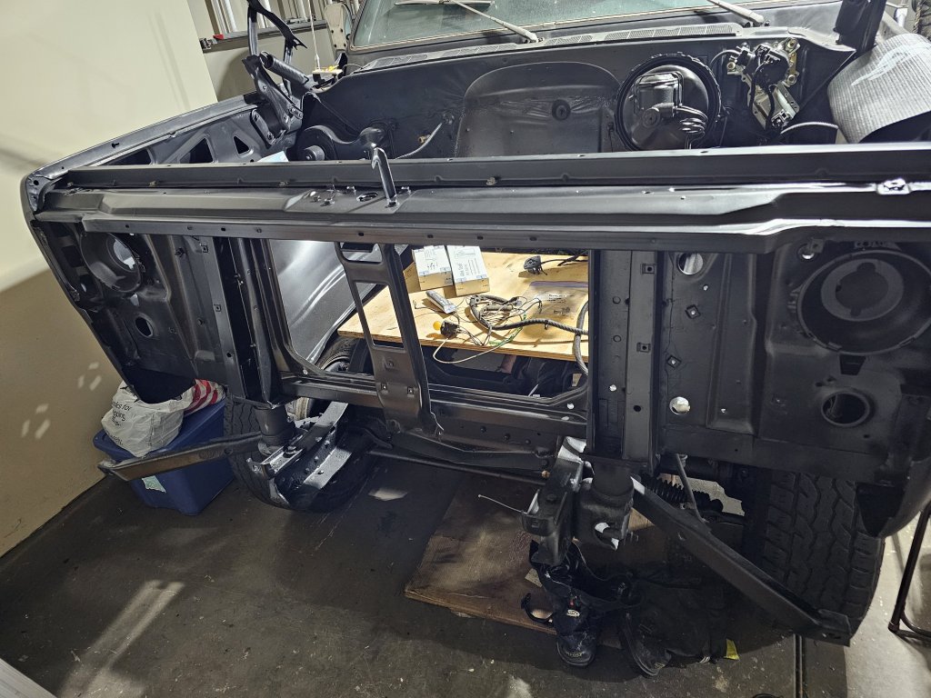

Does anyone have a picture of a 78 GMC square with the GMC unobtainable grille removed? Picture of front of truck from fender to fender just the grille and light bezels removed.

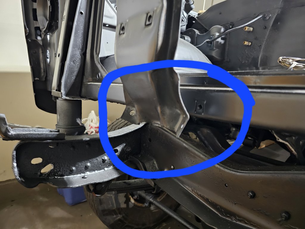

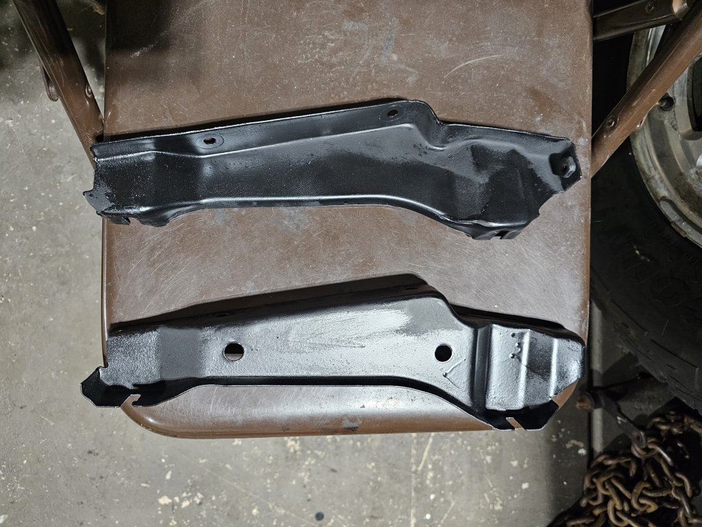

I have all removed off mine I think im missing a support piece want to see what it looks like assembled minus grille and bezels

The center brace bolts directly to the core support. Looks likes someone forgot to unbolt it before and twisted it up pretty good or something like that.
The outer brackets go on the ribs with those two cage nuts, with the nut on the bracket going up to be bolted to the upper filler panel.

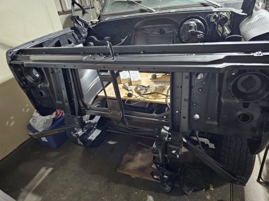

I have an '80 K25, they should be the same core support from 78-80. Mines assembled, but you can see the bottom mount from underneath. Here's what mine looks like.
