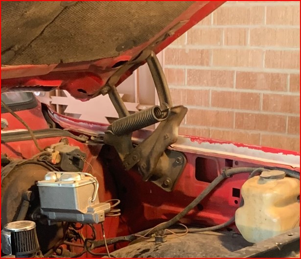

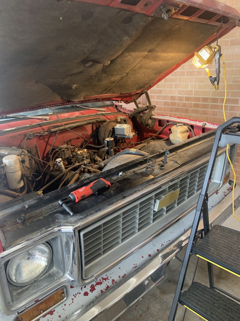

I have a 74 K5 Blazer..... here are a few shots of the engine bay and a closer shot of my hinge. Maybe you can compare and contrast. Feel free to reach out if you need any more pics. MK

Thanks Mike. Those shots particularly where the hinge bolts to the inside of the fender looks just like mine. Sadly, I boxed up the pair I bought and sent back to Charlotte today.
If you would, could you measure the distance of the two hinge to hood bolts? Mine are about 11.25 inches, the ones I bought for 73-80 are 8 inches.
