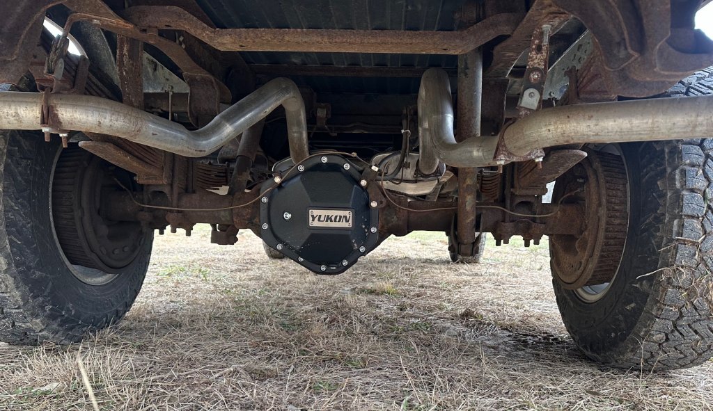

Rather than post in the almost-1300-post "What did you do to your square lately??" thread, I thought I'd post my experience with a Yukon HD diff cover and LubeLocker gasket install on my '86 M1008/K30.
All fluids on the truck were changed by the previous owner of my truck - and verified clean by me - except the rear diff. That fill plug was corroded enough that a 3/8" socket extension wouldn't grab enough to open, which is why I'm pretty sure it was skipped during the other comprehensive maintenance updates. I welded a nut onto the fill plug, got it removed, and found the diff fluid to be full, but milky from some water intrusion at some point. I installed a new fill plug for the time being, and then spent a little coin and ordered a Yukon cover (which has both a fill and drain plug in it), and a LubeLocker gasket.
The Yukon cover is definitely a nice, heavy-duty, piece, and had excellent packaging that allowed it to arrive with the powder coat in pristine condition...very much appreciated. The only snafu I ran into was that the cover was designed for flush-mount cap head bolts (stainless bolts included), which is a great design feature. However, it didn't allow for mounting the two OEM brake line brackets that were originally bolted to the diff cover. I was able to pick up some spacers from Ace Hardware, and three hex-head stainless bolts from my local mom & pop fastener shop (Shamrock Fasteners here in Greeneville, TN), and that did the trick. I chased all of the holes in the center cast section, carefully cleaned the gasket surface, and installed the new cover and fresh new gear oil.
I'm very pleased with the quality and stoutness of the aftermarket cover, and as a first-time user of the LubeLocker gasket, like that I didn't have to use an OEM paper gasket or Permatex Ultra Grey Gasket Maker.
I would definitely recommend both products!
