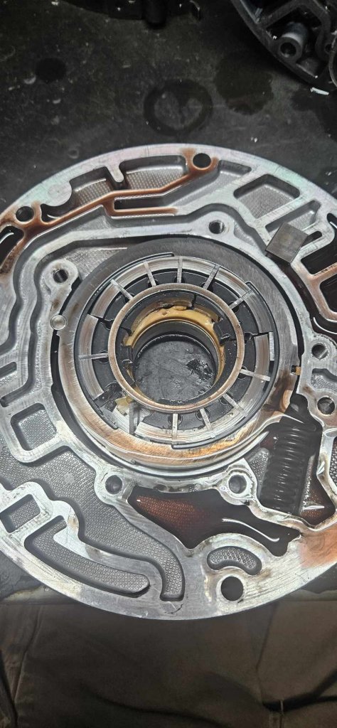

Got the trans out, took it apart to discover what i suspected.
Destroyed front pump. Theyre notorious for smoking front pumps due to torque converter depth... for whatever reason the 4200 flywheel pulls tbe TC way out of the pump. So if you get one of these things and its got a bad trans, this is usually why.
I measured the flexplate- to - engine and then TC to bellhousing and when you bolt it together, right away it disengages the TC by .200" from the front pump. Sometime more with other flexplates.
Anyway, i built a good trans for it.
Boost valve, wide 2nd gear band, good ol raybestos clutches, i modified 3-4's clutch piston and played with snap ringa and such until i could get the clutch drum clearance mega tight. Like .035"
Corvette servo for the 1-2 and 4th.
I blocked 3-4 and 1-2 accumulators off with billet block offs i made. Biggest sunshell i could find, 5 pinion plantaries from a 4L65e, as well as input drum stabilization for anticipation of 4x4 boosted shifts, so it doesnt snap my input shaft off. Its basically a collar to help support the input.
Many other things, new solenoids, new pressure switch, harness, plugs, etc.
All valves in the VB have been polished and cleaned. It should in general be a nice, smooth running 4L60e that'll shift really good with some additional tuning on the laptop.
