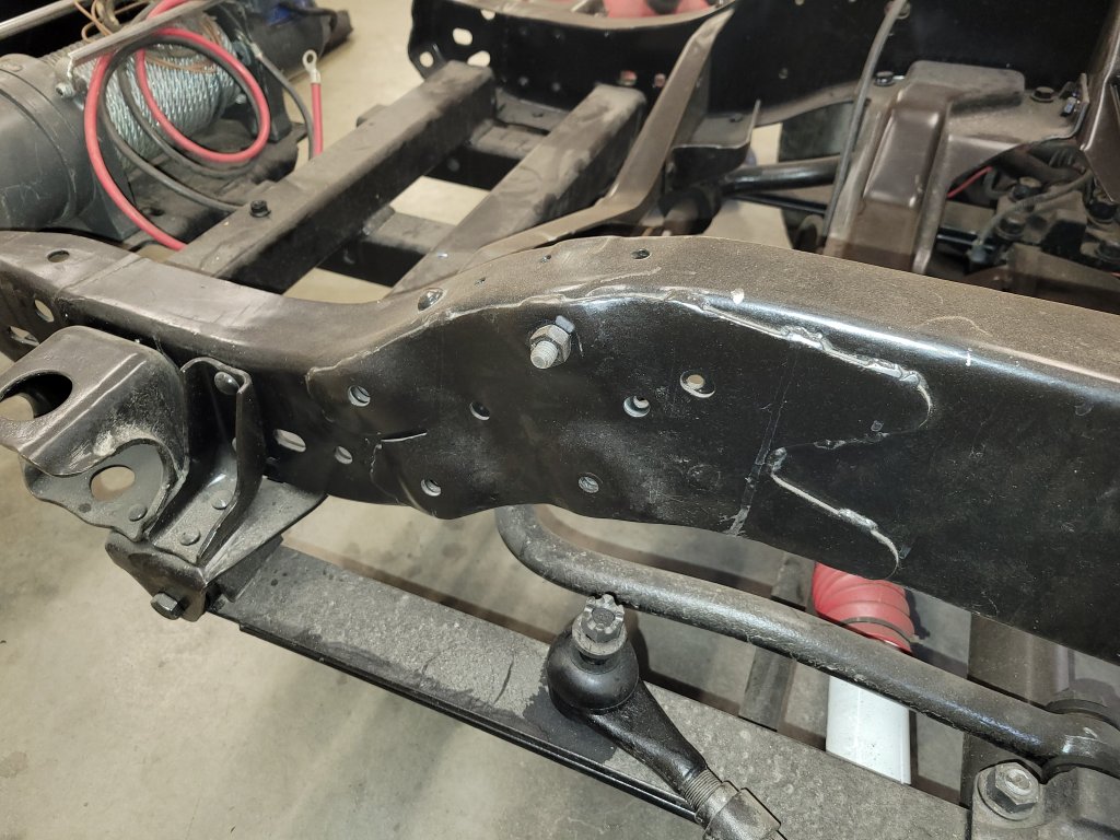

To fix it right, and I know you will. You'll need to grind the crack into a V on both sides. Weld it up. I used both methods to fix mine. I bought the brace from Auto Fab (make sure you get the one for 2wd) and I bought the weld on plates that weld to the frame from the side and bottom at the steering gear. I went to Ebay for my frame plates they were like 50 bucks IIR.

Very common unfortunately. The crack/cracks will need to be welded (grind down around it, find the ends of the crack and drill them out so they don't spread farther, sometimes even after welding they can reopen or come back, but if you drill a hole at each end now it's "contained" to that one section. Then they sell braces to strengthen that part of the frame so it doesn't happen again, and it kind of acts like a patch panel as well.
Whole bunch of different vendors sell them, get whichever one you like best. They sell super cheap no-name kits and some that cost a little more, but none are terribly expensive. Basically just a chunk of metal that is the right shape to fit.

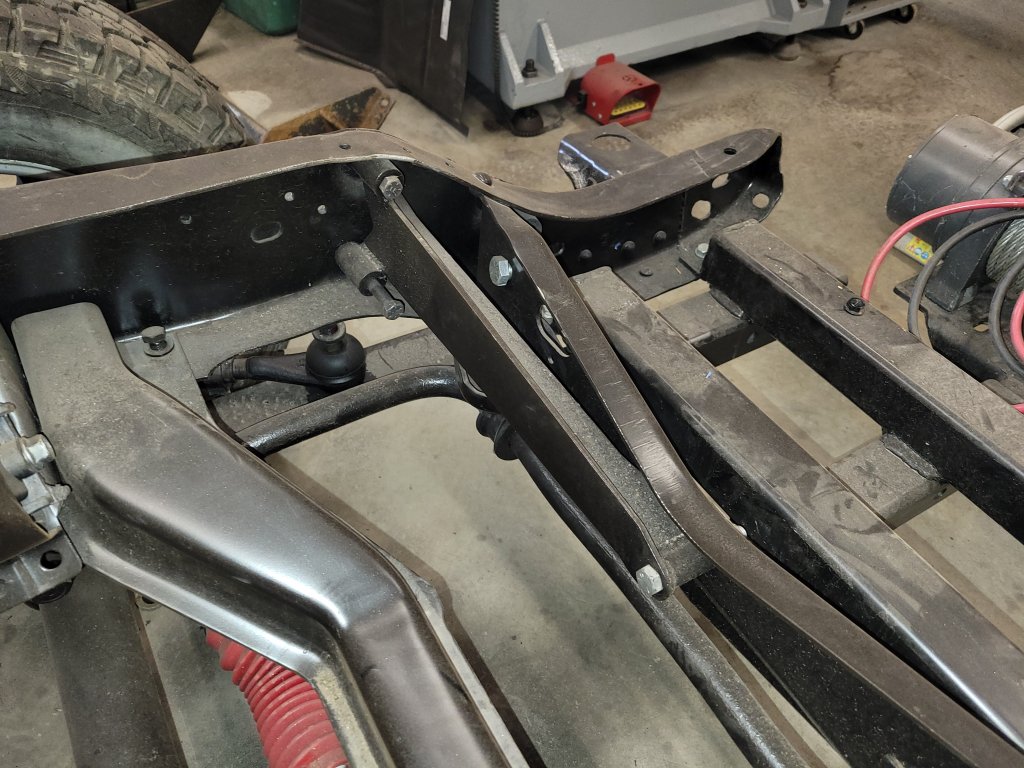

In addition to the autofab braces which connect to the rear box bolts, I would also add the frame braces from Ridetech. They triangulate the front end and connect to the front steering box bolts.
And lastly, make sure the front crossmember rivets are tight and front bumper brackets.

On my 76 K5 restoration, I beefed up this area. The frame had slightly cracked on the previous owner, and he did a pretty good job welding the cracks closed. Since I had the access to this area, I went to the next level. I welded in the vertical support piece others have mentioned. I did not use the under frame piece since I did not have welded cracks down there. I also added the I beam that transvers that rocking force to the center of the front cross frame beam. Now the frame under the saginaw box should not see the abuse that the stock design was subject to. The cross beams that you see way up front I fabricated. There are three 2" receiver tubes. The middle one is for a 9000 Ramsey winch. The two outside ones will support a custom carrier yet to be designed. This is where my spare tire will reside. The back of the K5 is getting a popup Four-Wheel-Camper!
