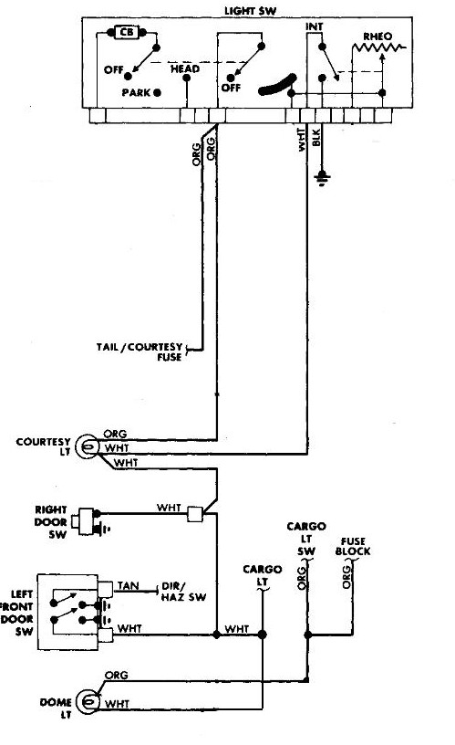

Interior light is on when door open, when I close it, the light goes out but the cargo light comes on. Cargo light stays on no matter where the switch is positioned. When I open the door the cargo light goes out and interior light goes on. They have this battle, one comes on when the other is off. Where do I put a ground? Isn’t that always the answer? Thank you all.
