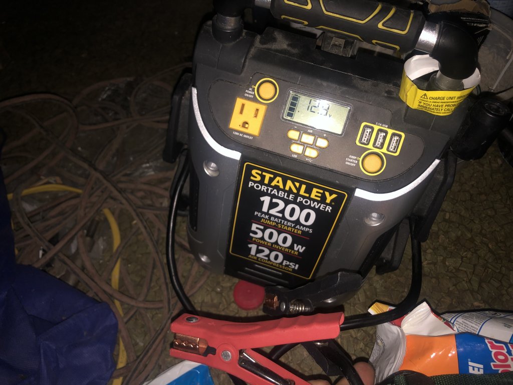

Where are you measuring that at? At the battery, you should have ~12.7v for 100% charge. 12.1v is less than 50% charge. 11.6v is basically dead. Do you have it on a battery charger and it won't go above that? Are you just reading it at the dash?
Yes I was measuring it at the battery. Thanks for the info I didn’t know 12.1 was only 50%, below is my jump starter I used to charge my battery. It’s definitely a step down from a real battery conditioner charger
