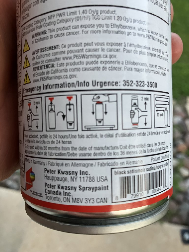

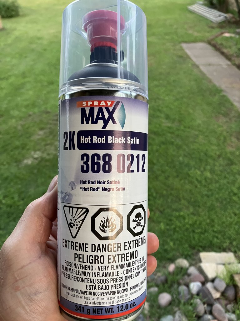

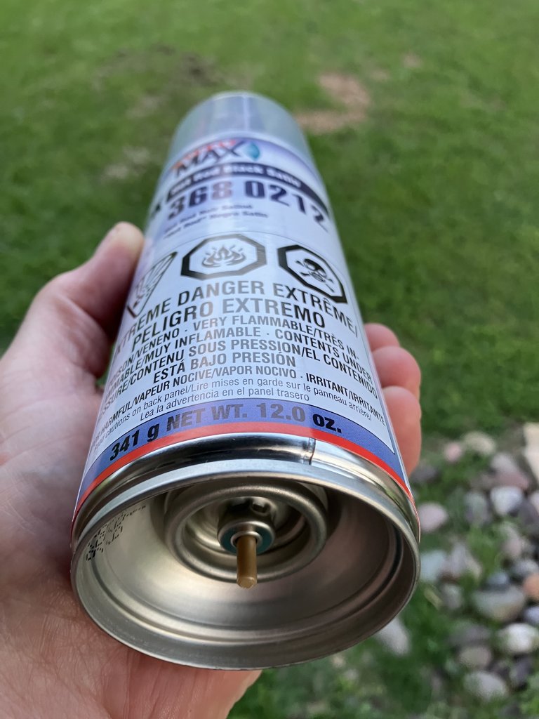

I just bought this SprayMax two part (paint and hardener) 2K satin spray paint to try on my vent window frames, steering columns and other misc parts. I haven’t tried it yet. Got it from Amazon but Eastwood sells a similar product.
