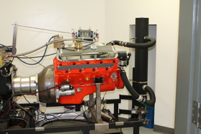

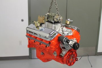

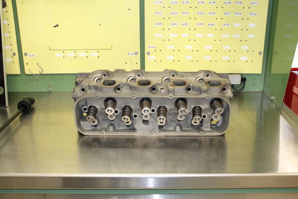

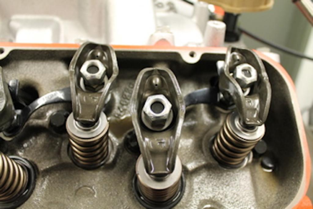

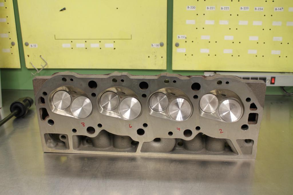

What A 500 + HP Peanut Port 454 Looks Like

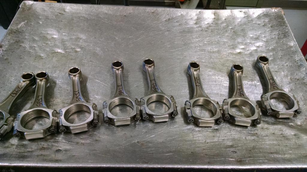

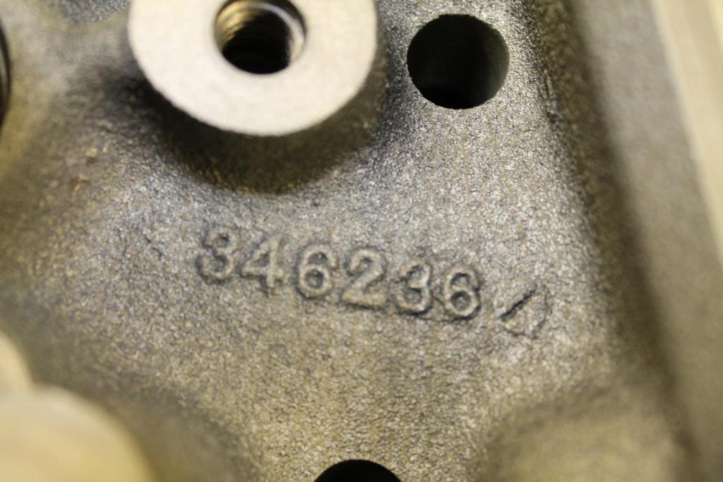

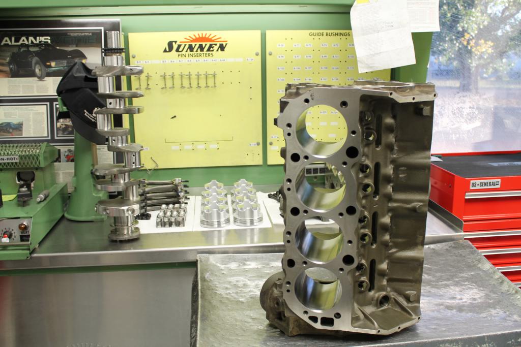

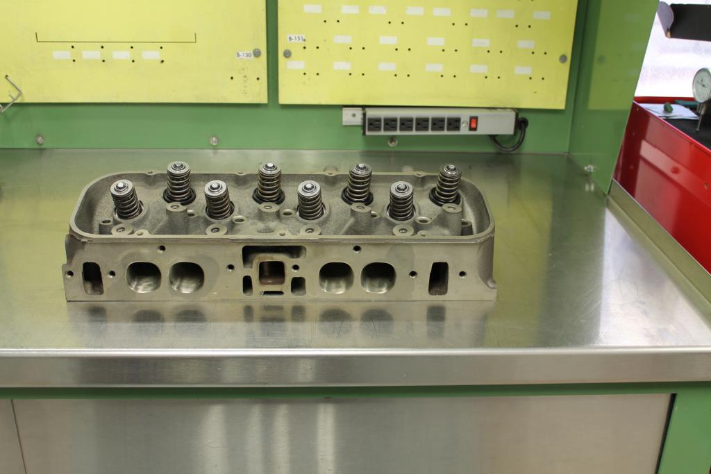

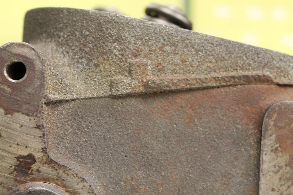

This smooth idle engine went on to run 10.30s @ 3720 pounds in less than sea level conditions. Never under estimate a peanut port head (236) or most Chevrolet production parts, as they can deliver.

So it appears like it ran with no alt, ps, accessories and an electric water pump,
And you ran pop top pistons to squish the chamber super tight (piston pic is blurry)
How much timing did it allow at peak power
