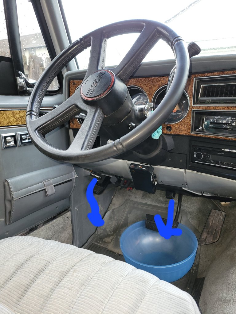

I have a suddenly new leak into the cab of the 1990 suburban. I washed the truck recently to knock off the road salt. after, I noticed some water on the driver floor. I just assumed that my 7yr old son directed some high pressure water into the door/body gap and it blew past the seal when he was "helping." but we have had some rain since then and I am getting water.
I went out during some rain today to investigate. The water is dripping out of the floor vent above the brake pedal. There MAY also be a small amount of water coming down the driver side kick panel way up above the ground bus bar. But that may have dripped in when I had the door open investigating.
My plan is to take that duct piece out and hose some water all around to try and locate the source. But I probably won't have time until this weekend to do that. In the meantime I have a small bucket to collect the leaking water, as there is rain in the forecast for the next several days.
It is such an unusual leak location that I thought maybe somebody has had a similar experience I could lean on to help pinpoint the water entry location.

i don't know where it is coming in, I suspect the windshield gasket. but most of the water was dripping out of the little floor vent (right above the brake pedal) that comes off the duct piece that runs under the dash from the main box to the lower left dash vent. there may also be some coming down the driver kick plate.
I have no idea how water was getting in that vent. I suspect it is coming down the driver side A pillar and coming in somewhere into the dash that it was getting into that lower left hand vent and coming out the little vent above the brake pedal.

The cowl drains seemed to be open and free flowing. There was tons of water flowing out with full hose spray into the cowl. Although I did seem to overwhelm the drain with full hose flow directly into the driverside drain. But I don't think it was designed to have that much water flowing to a single side...
I did notice that the top, driverside windshield gasket was pulled back from the cab to where there is an opening there. I can only surmise that water was flowing in there and overwhelmed the drain hole at the bottom of the windshield channel, and got into the cab that way. I didnt want to water test it, because then there would be water in there and I'd have to wait for it to dry out before sealing it. So I pulled the gasket back and squirted some weatherstripping adhesive in the gap and also "caulked" the gasket-cab seam on the corner with the adhesive. I had planned on using a flowable silicone, but read some information about that not being good on paint. It should get a few days to cure before any rain is in the forecast...fingers crossed things stay dry on the inside.

I did decide to remove the plastic access panels at the base of the fender at the drain outlet to see how the drain outlet looked. I started poking around and I couldn't believe the amount of stuff I got out, particularly on the driverside. I would get all I could with a thin rod, run some water to flush more down, and keep repeating. It took me over an hour before I couldn't flush out more stuff. It was a wet and dirty job, but worth doing after 32 years.
Hopefully between sealing the top corner of the windshield gasket and cleaning the drains, the cab will stay dry for another 32 years.

update- we had about an inch of rain last night, some of it very heavy. the cab stayed dry, so I am hoping that we have resolution!
