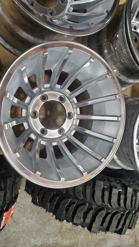

I'll be going through this myself at some point. Bought a vintage set of turbines as well here just recently and they didn't come with the lug nuts either. Didn't give this much thought until now, thanks! And yeah the lug nuts are there for centering the rim and the washers spread the load of the clamping force through the wheel and hub. As long as it's tight when it's torqued down properly it shouldn't be an issue. Now if it were on a unilug set of rims, that would cause a concern because it needs the washer to be positioned properly for the correct rim spacing pattern.
Btw, are these the lugs you've gotten for yours? Lug Nut Guys Mag Nut
Image for reference of my rims

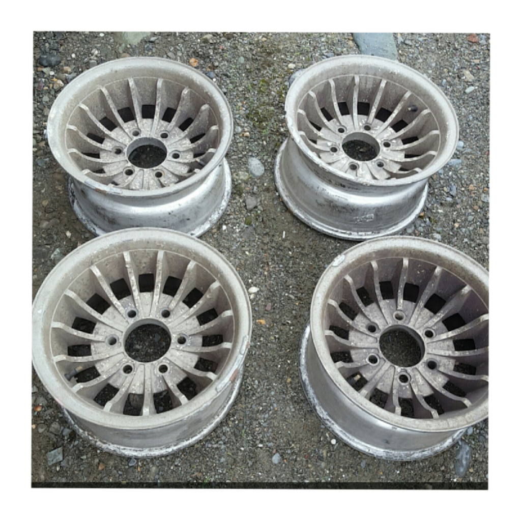

I have a matching set of 4 I've been meaning to list. 15x10, 6 bolt pattern. I've owned them for 20 plus years, haven't been on a truck in about 15..

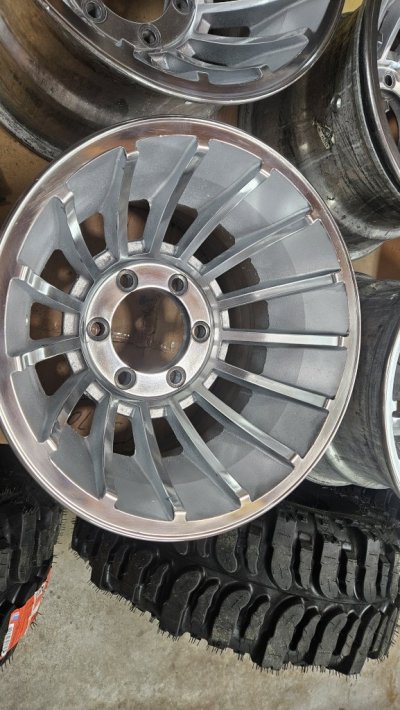

Are they Westerns? The 15 spoke Cyclone IIs? If you'd be willing to ship them to 30214, I am interested, depending on the condition.

They are 15 spoke but not exactly same. These have years of shelf dust and grime on them. No pits/corrosion or gouging. Definitely need a power wash which I can do.
