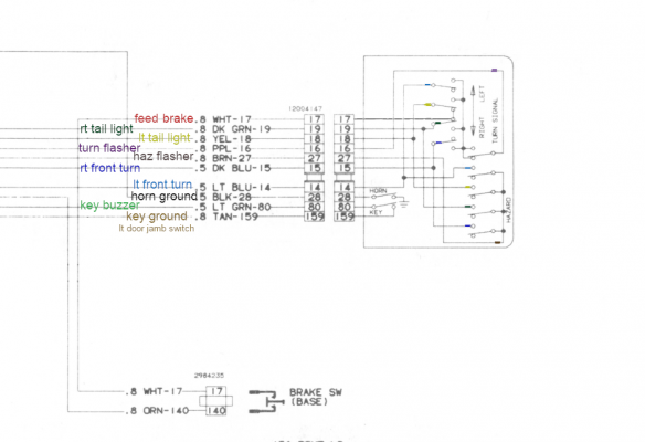

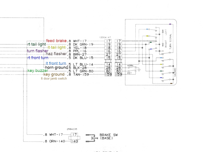

Information to help you
Wiring diagram link
Video explaining brake light turn signal
attachment- don't know if it is needed, but it might help you start with the wire diagram
just a part of the wire diagram that is labeled.
My bet is it is a bad turn signal switch. unless someone spliced wires.
