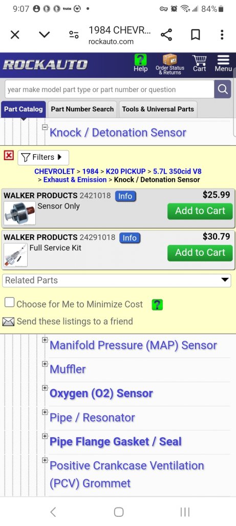

M code was low compression 350 HD emissions,so very doubtfully it would have knocknsensor
