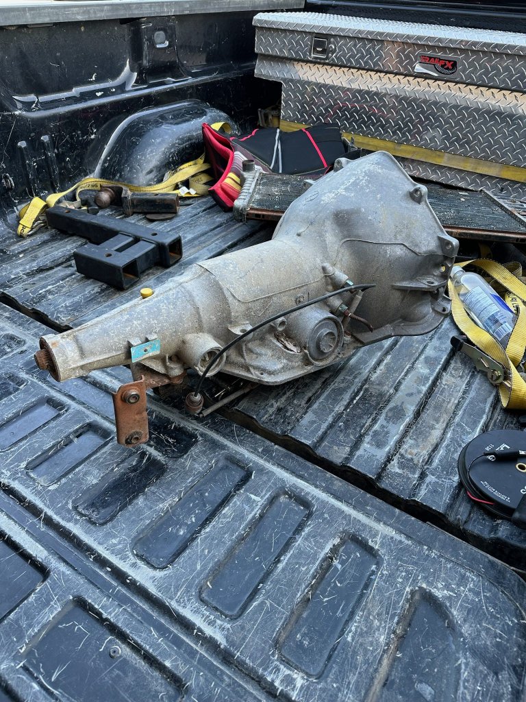

I picked up a scrap truck for a few parts and this transmission was in the back. Can someone help me by telling me what it is? I'm thinking a th350 but I'm not positive.

That may not be a Chevy. Let's see the pan.

Looks like a TH350. We need to see the pan shape.

Turbo 200?

It's not a BOP. I thought someplace on this website or GMT400's there is a guide for GM transmissions based on pan gasket shape.

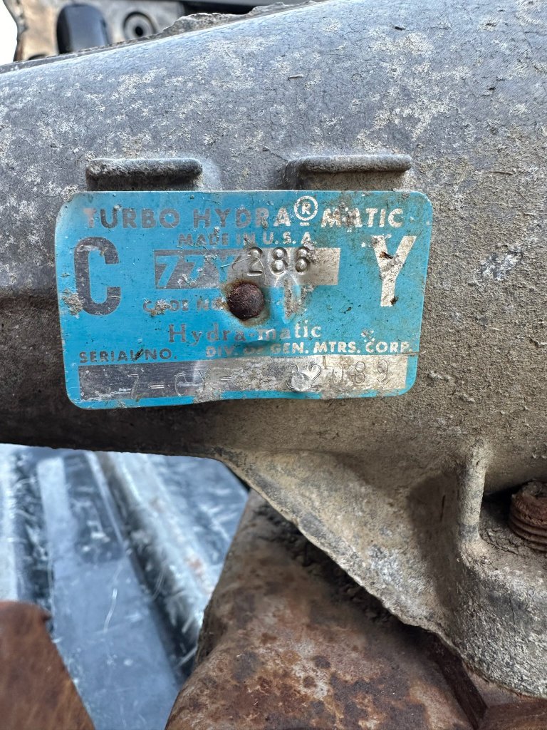

Its a TH200. The CY code puts it between about 1976 and 1981. Def a Chev bell housing.
Not a boat anchor necessarily. The best bet for this, IMHO, is to look for it a home with a circle track or drag racing group. These are popular with some of them due to the light rotating mass... like a Powerglide with an extra gear and they've been outta production for 35 yrs or so.
