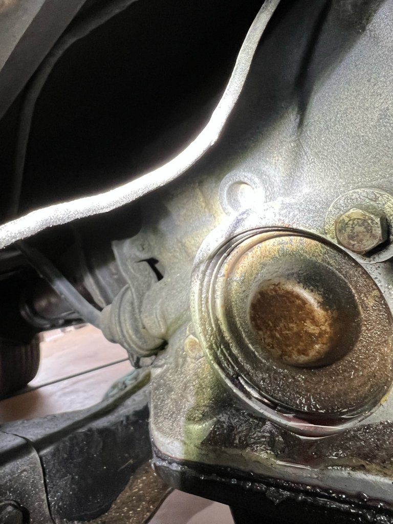

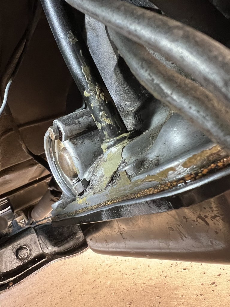

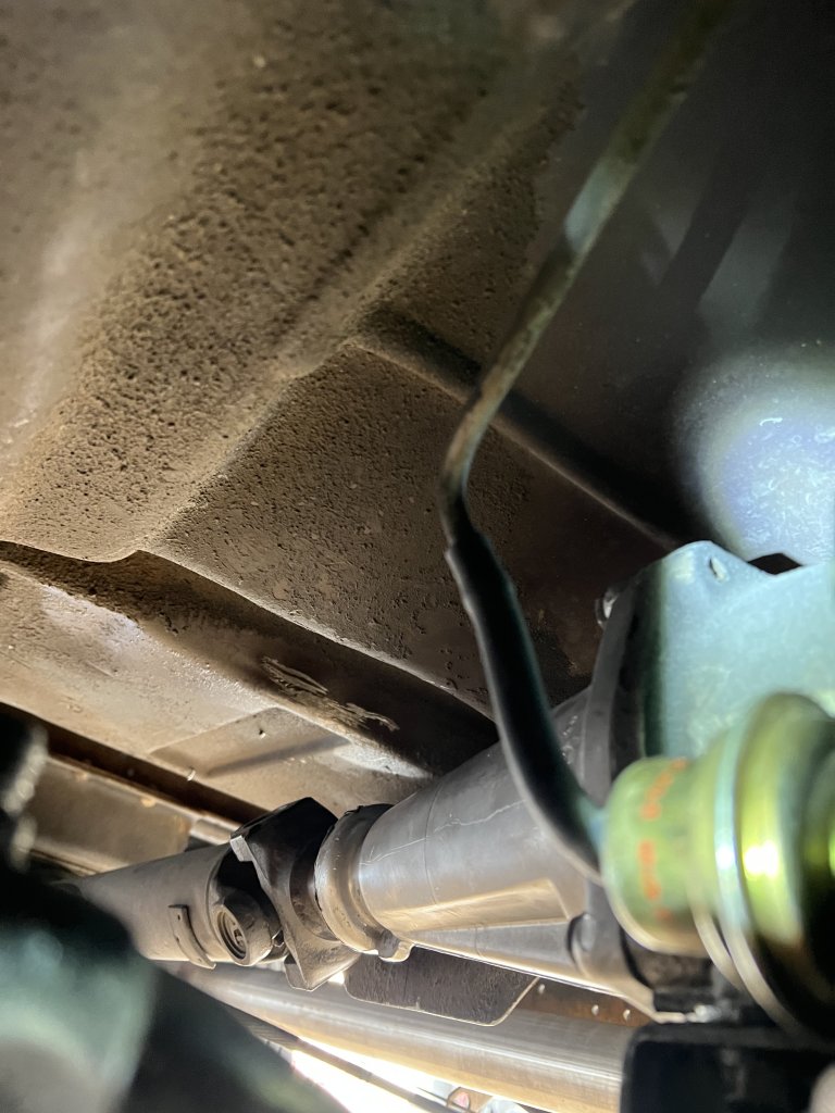

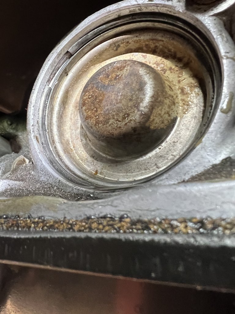

You have a pic of the one in tranny? This is ours with some PO sealants all over. No leak here but we just did accumulator, pan and kick down seal yesterday. Hopefully it’s not leaking anymore.
