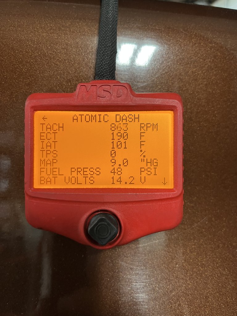

Hi guys I have a 1978 Chevy k20 with a 400sbc I’m having issues with my temp gauge I feel that it’s not reading right. I have the msd atomic efi and I was looking at the temp reading on it and it says 190 but I look at the gauge on my dash it reads below the first mark off of cold. So I’ve been ohming my temp sender and at 190 degrees it reads 135 ohms. So I wonder if it’s a wiring issue?
