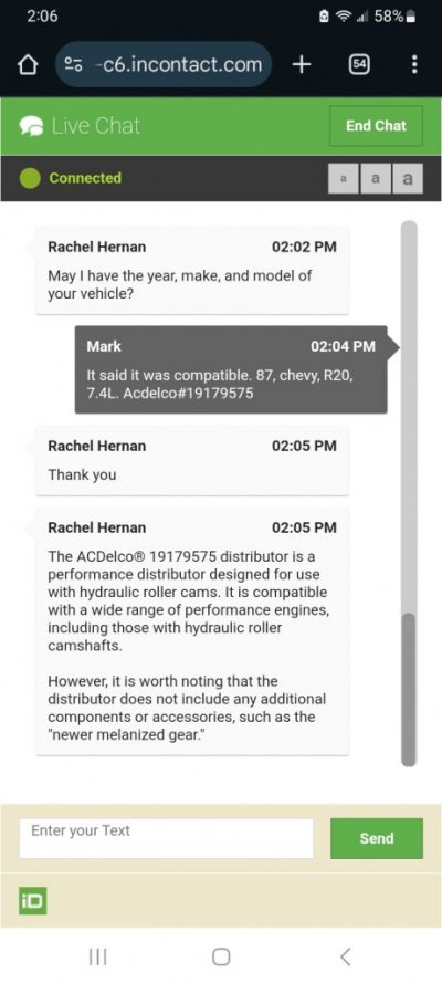

Ugh,
My 454, TBI distributor is a .427 shaft, I need a .491 or .500 to order a distributor melonized gear for comp hydraulic roller(11-412-8). They don't make one for the .427
Replace the distributor and coil?
I am having a hard time finding one.
Recommendations pretty please
