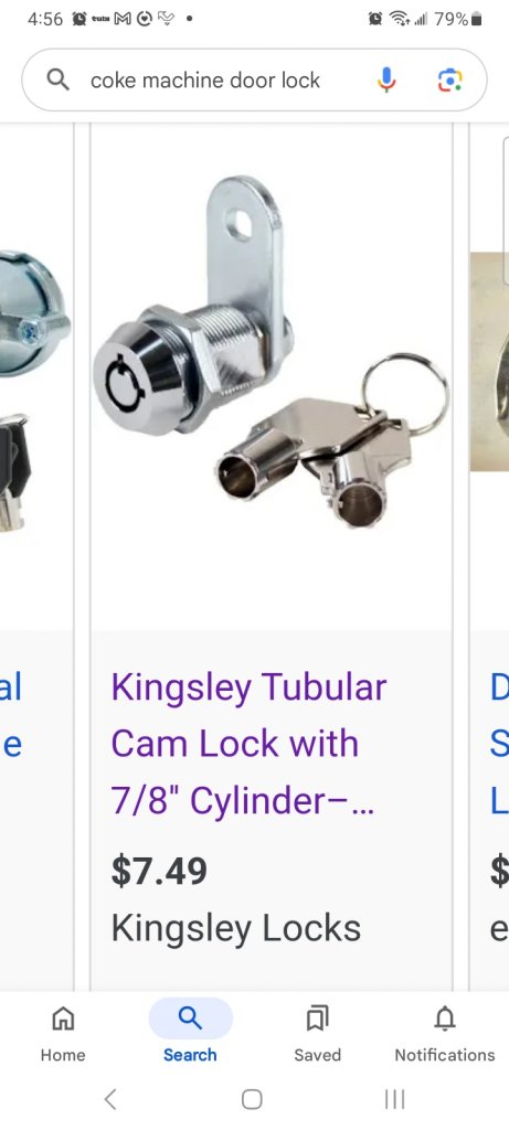

Install this in the tail gate like a door lock,attach 1 latch pull rod to it,so you have to turn it to pull one latch in,luft the handle for the other. Or use an electric pull solenoid with a reed switch or keyed electric switch. It would make opening a 2 handed operation though. Another thought would be install this with a pull rod or wire going from this to the handle. When it's turned one way,it pulls at the handle in the opposite direction preventing a pull rod from pulling out the latch.
