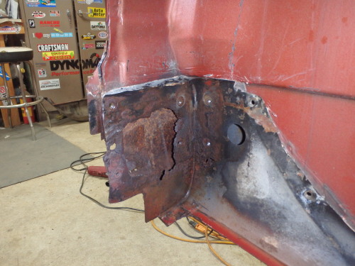

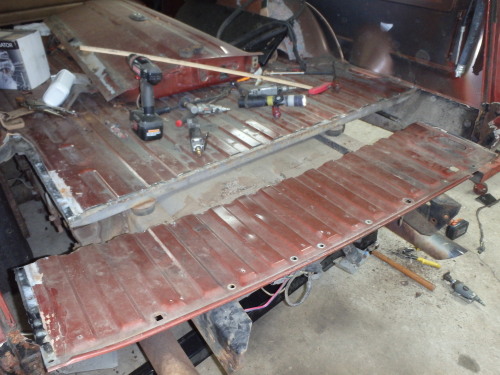

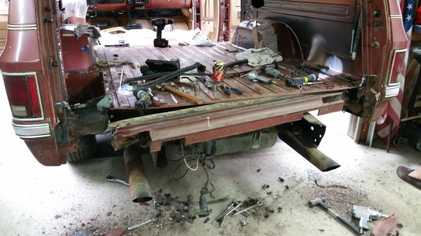

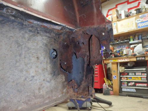

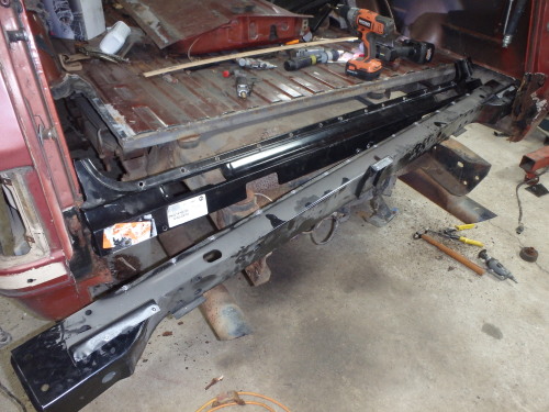

Hi Dave,
Let me give you some ideas about the rear cross member removal and replacement. Its not going to be a simple bolt in/out application. I am currently working on my 86 Sub, having to replace my cross member due to a rust out condition. Its a tailgate model and I plan on keeping that way. The old one was relatively easy to remove because it was in such bad shape. It came out in 2 pieces. While its true its mostly held in with a bunch of bolts, there are spot welds holding on the bottom sheet metal area to the corner areas of both left and right quarter panels.
Now the fun stuff! The new cross member is one piece and will not simply bolt into place. You either need to:
1. loosen all of the body mounting hardware and jack the rear of the body up high enough to slide the member under both quarter panels and into place or
2. Cut the rear of the floor pan back far enough so you can lay the member diagonally on the rear of the frame and then slide it into place.
I felt that option 2 was an easier path, so I cut my floor at the rear-most floor support, unbolted 2 bolts from the lower pass side, broke 1 spot weld on the far right floor support, cut the seam-sealer on the pass side and removed the spare tire well.
As you can see from the pics Ive had to make some creative patches on both quarters so that I can bolt the new member back into something :)
Hope this helps you with a few ideas. Here are a few pics of my project.
