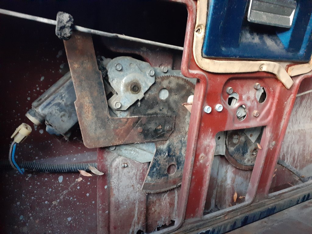

I took a pic of the motor. Had a friend take it apart. Unfortunately didn't get pics of the inside but it was dirty. I got it back together and added 9vdc to motor out of frame but it wouldn't turn. The armature is trying to do something. Wondering if it needs to be grounded in frame for it to work proper.
The motor body is the ground. Apply 12v to one terminal to operate in one direction, then apply 12v to the other terminal to operate the other direction.
They don't operate like your typical car window motor of the last 30+ years.

So an update on the unmovable tailgate window...
I installed the window motor. Turned the ignition to on, pushed the downside of the switch and it came down an inch and stopped. So I tried pushing the up part of the switch and got no upward movement. Tried down and came another 1/2 inch and got nothing after that... I have not thoroughly inspected the gears or the levers as this is very new for me. I will tackle this later. Any info to diagnose would be greatly appreciated.
30,396
28,178
Yep, start with what I suggested up there in post #3 I think it was. You need to determine if everything is getting power, and enough of it.
Did you try the key switch at all?
