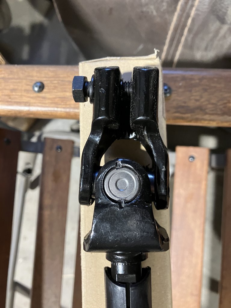

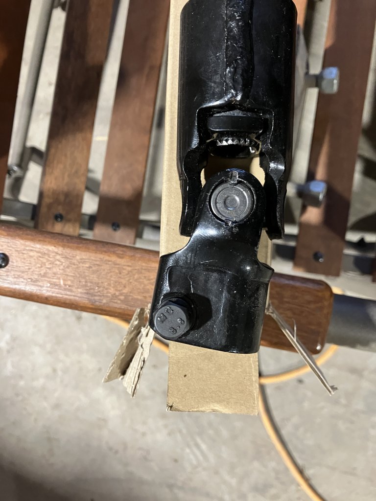

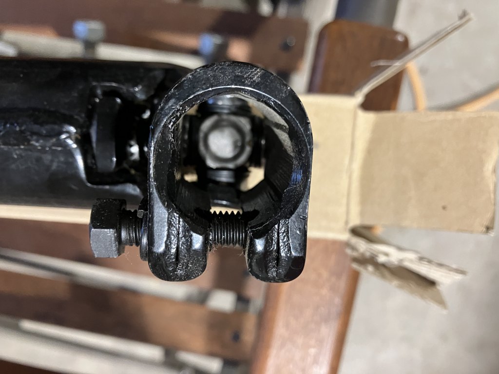

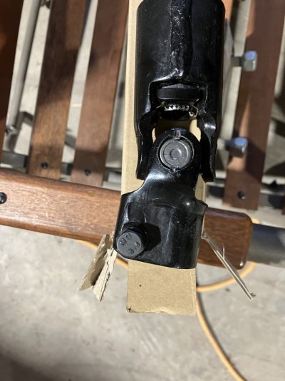

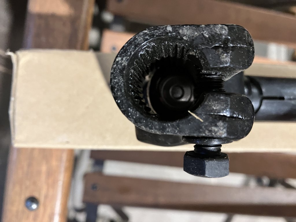

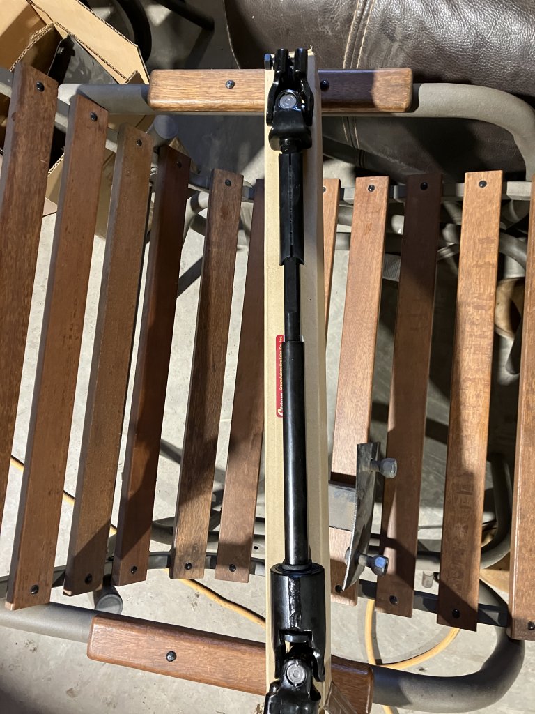

Dan, I think this is what John is talking about.....I plan to install after frame is done. D and spline. blow up the last two.

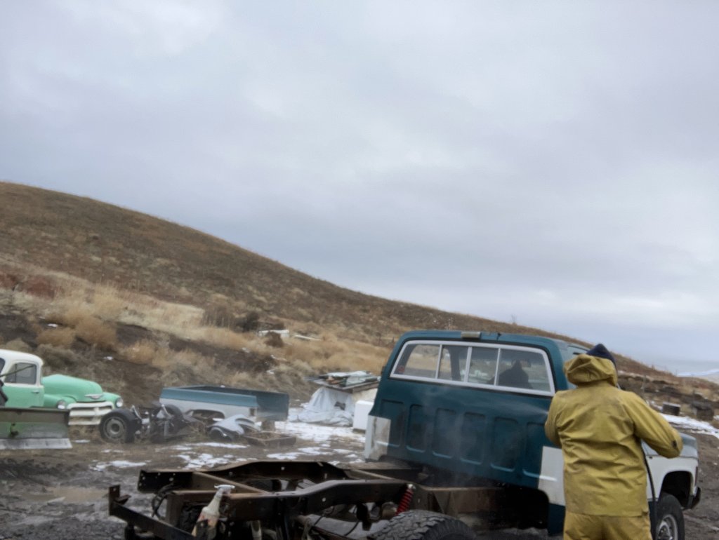

Frame is pretty nice considering the guy that bought this was a logger lived in Poulsbo, used in the hills for thirty years, attested that these are good tough trucks. Some fun!!
