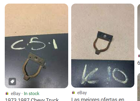

I don't have it anymore. Don't know what I did with it, it musta fell off and become lost when I took the cluster off. Trying to find a new one, does it look like this?

Yes.
