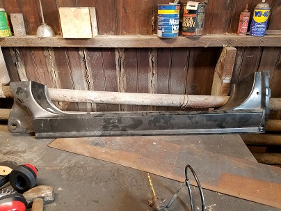

This is my rocker

That's full style rocker, you're good to go :waytogo:
