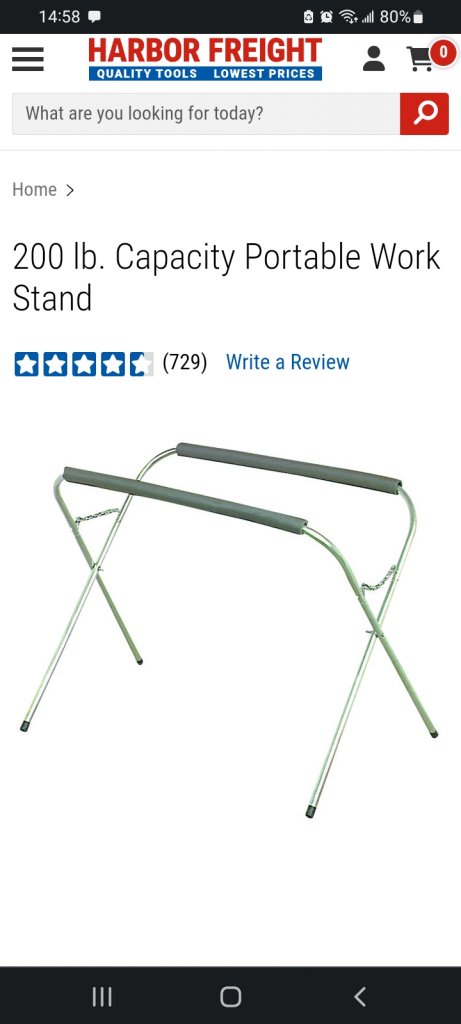

I used 3 body work stands from HF to hold the bed.
Not all the cherry pickers work well. Look for one that has a long reach. The cheaper HF does not and while it's what I had and used, I don't recommend it.
Any Ideas what HF actually calls them?
With as big of a POS as my Pile is, I might need to look at some.
I searched by Bodywork stand and Body work stand. Got a fender cover.
I was thinking about building something out of 2x4 or 2x6s and putting some casters or something a bit bigger on it, to be able to roll it around on concrete or gravel.
But If I can find something premade that fits the bill for the same or cheaper, even better.

200lb capacity portable work stand
I said 3 but it was actually 4 now that i think about it. I used 2 up front and 2 in the back. I put them inline with the bed if that makes sense. Also I used ratchet straps around the stands as I didn't totally trust the chains/ hinges. I know they say rated for 200 pounds but with most HF items I usually limit to 50%

Thanks all. I think HF is Harbor Freight. Thanks again!

I used the HF saw horses. The pair held the bed rock solid and has a capacity of 2000#. $50. It's $84 for the 4 body stands and cap is 800#
