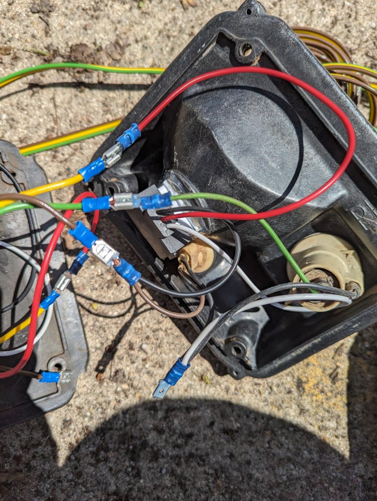

I recently bought a 1979 short bed Two-Wheel drive. There were no working tail lights so I have been working on building a harness. I have a few different diagrams, but, I am having a hard time figuring out where everything plugs in in the cab.
I tried to test for continuity on the old harness and didn't get any response so I basically copied it with a 3 wire trailer harness that I added a ground too. I have also built new LED tail lights to go in as well. So wiring for that is a little different but for the most part the same. Just need to know exactly how and where to tie it all in to make it function for both the brake light, reverse and turn signals.

Dark green and yellow are you left and right turn signal AND brake lights. Their function is split up in the turn signal switch.
Brown is the taillights, light green is reverse lamps. And all of those individual bulbs needs a good ground.
Before investing a bunch of time in the project, verify the wiring to the rear of the truck is good. The smallest of the firewall connector (on the back of the fuse box under the hood) is the taillight connector. Use a test light and verify the turn signals, park lamps, etc work there before questioning your handiwork and the rear of the truck. If there is a trailer light connector, you can almost guarantee you need to start from scratch. You will probably find a dozen cheap crimp connectors and at least as many splices held together with cheap electrical tape.

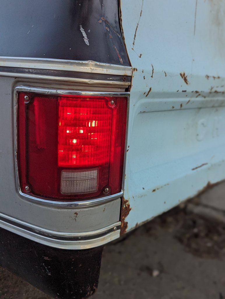

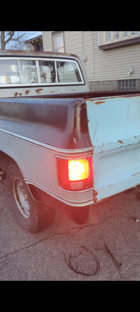

Well it was cold as heck last night but ended up figuring it out. Traced all grounds and swapped mechanical relay with led relay and had to bridge the two connections. Only got one side but it works! Sometimes the easier dumbest answers are the right one. Thanks guys!
