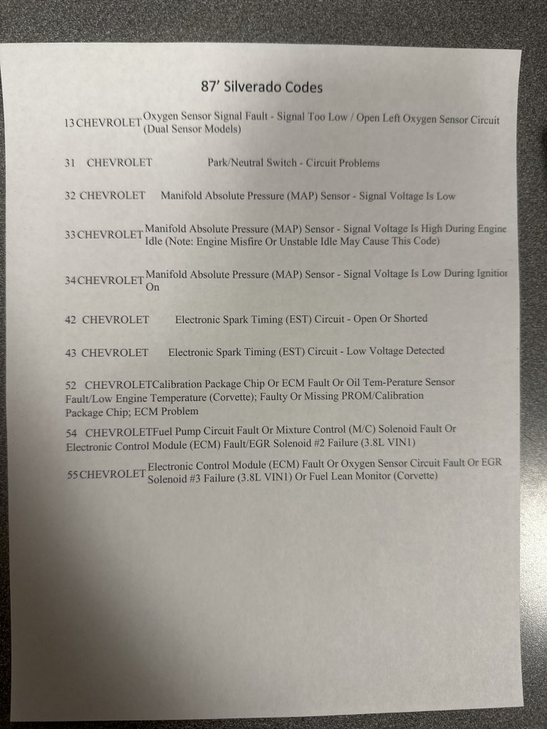

Hello all. I have a 1987’ silverado single cab king bed I’m working on. On some days the truck runs like a brand new one and on other days it won’t start at all. No rhyme or reason. Attached are the current codes I’m getting. Recent work I’ve done in hopes of resolving this issue are as follows.

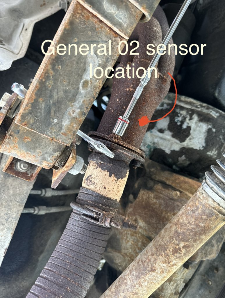

Based on codes your getting I'd start chasing wiring harness and look for any issues. Also that 02 spacer isn't needed and could cause more issues
It's designed to run around 650 degrees.
Also the sensor should be 4-10 inches from collector where primary tubes connect
Collector gasket leak will.make it run bad too if sensor is close to that flange

Those are all circuit codes,that's the only thing that bunch of codes has in common. Check the alternator for A/C ripple make sure all engine and body grounds are in place and clean.

Just to make sure we’re on the same page. The O2 sensor is mounted on the header itself does this need to be moved Further back on the exhaust?
It being mounted there was what concerned me with over heating as I’m not educated on where it was originally located on the exhaust system since it’s all aftermarket. I just know the O2 sensor has gone out more than once. Or something else is causing that fault code.
After I replaced that O2 sensor it fired right up and ran fine. It wasn’t until a few days later that the rough idle and stalling started to occur again, as it was prior to O2 sensor replacement.
I’m at work today at the FD but I will upload some more pictures tomorrow of the exhaust and O2 sensor location after I get home. I’ll attach a photo now of the general location of the O2 sensor.
