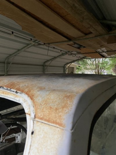

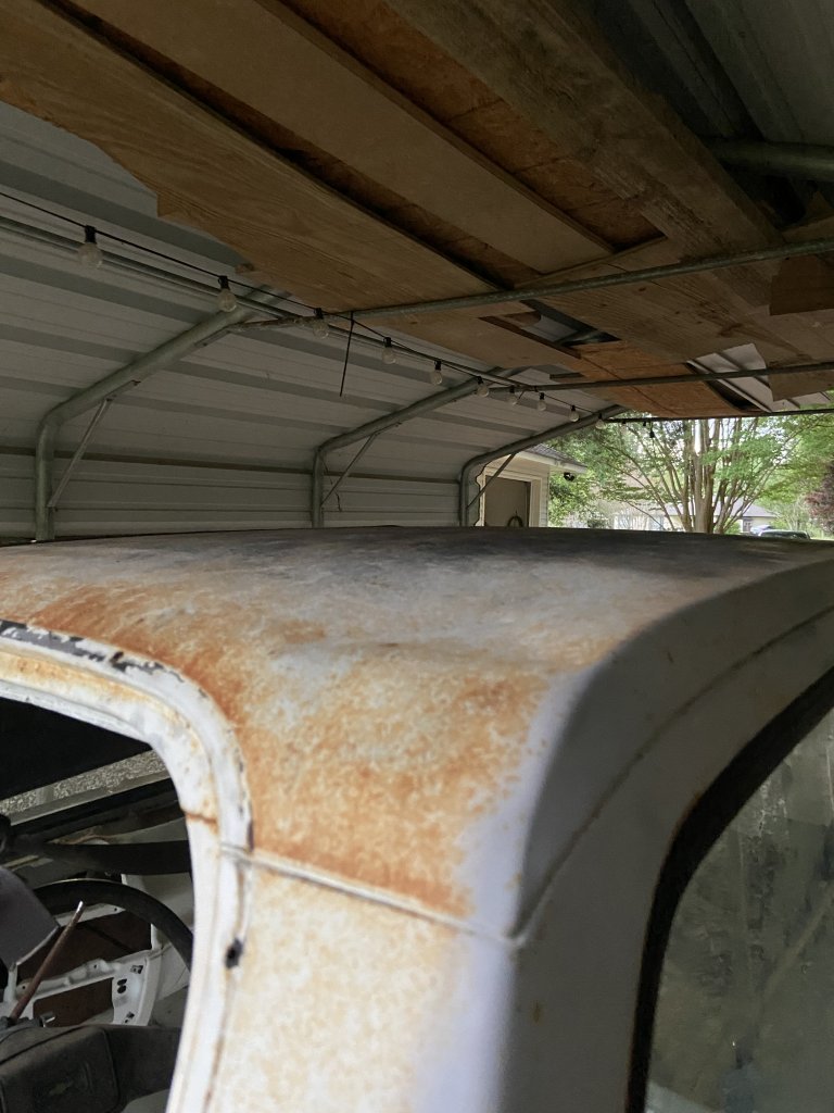

So I have this dent in the roof of this cab. No access behind it due to the inner “ceiling” panel. What do you guys recommend for trying to get this back out. It does not have to be perfect as I am still bodyworking. So I will use filler to smooth out if need be. Just wondering what my best approach is.

I’m no pro by any means but if it’s not just oil canning (those dents that will just pop in or out easily) then presuming you don’t have a stud gun or the adhesive version, tack weld a few studs to it. Small all thread or #9 wire etc. something you can makeshift a slide hammer on and attempt to pop it back out.
5,372
8,567
IMHO the only thing that looks it's holding that dent is the crease at the very back above the window try welding some rod along that back edge and pulling up gradually with vise grips from either side of center one side the other working towards center. You can make a simple bridge with some scraps of wood to pry up with diagnose cutters if needed. Then I think the rest will massage up working the perimeter with pressure from the inside work in a horse shoe shape starting at the front working the outside edges first. Do not smack the center. You still may end up oil canning in which case you will have to shrink the metal. We'll cross that bridge when we get there.
Was my exact plan, just wanted to make sure there wasn’t something easier I was missing.

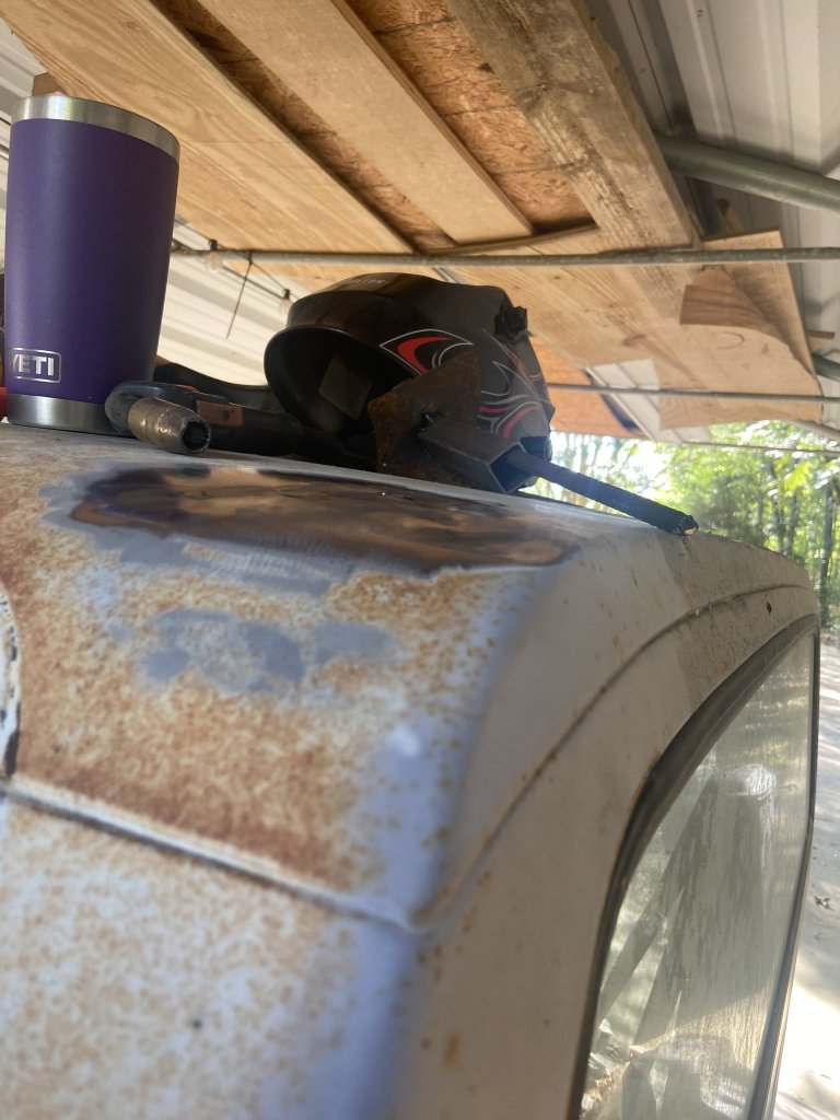

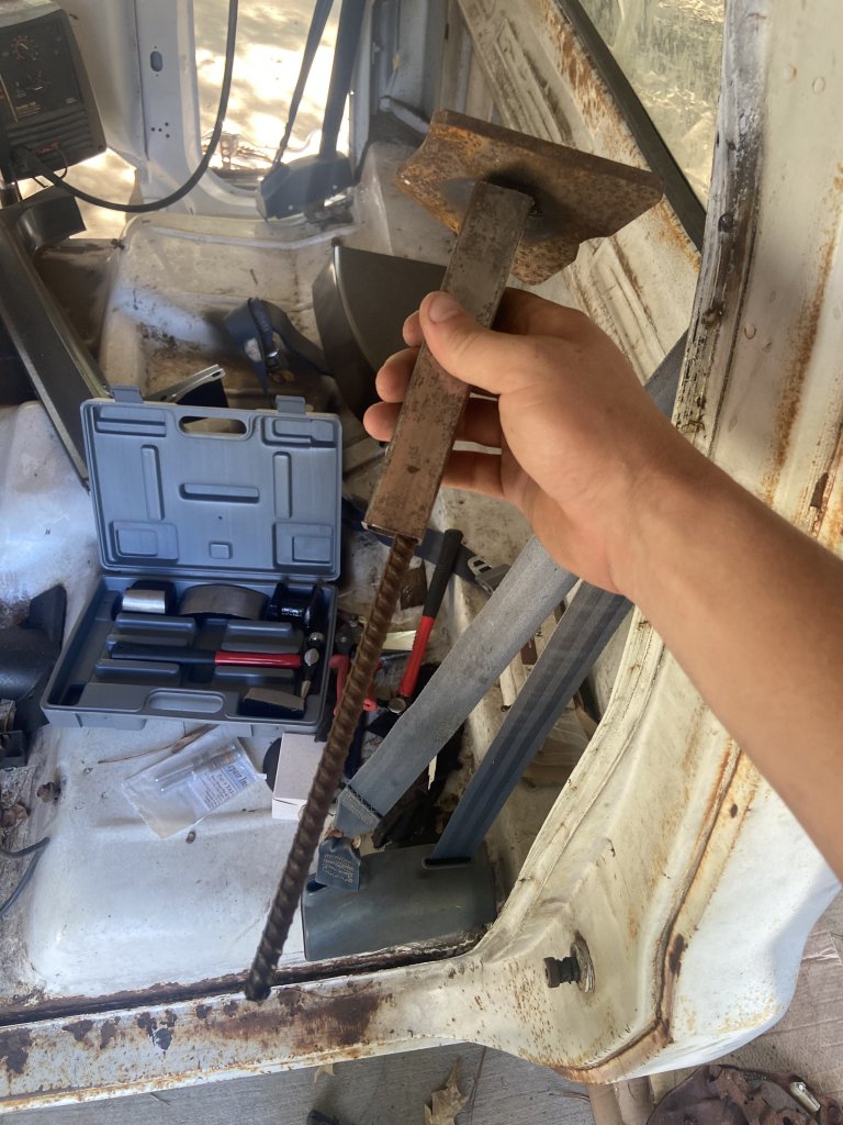

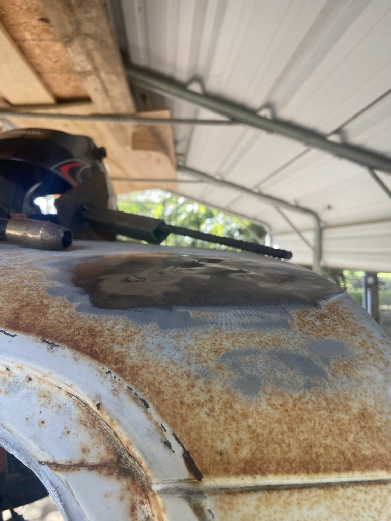

Gave it hell and it just wouldn’t pop up all together. So I have some lows to work with after blast/epoxy, but no big deal. Made a makeshift slide hammer. Thanks for everyone’s tips.
