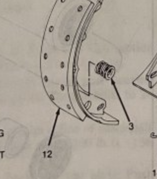

these are lever pivots for the rear drums. My question is why did spring kit come with 2? I ordered a kit for each side so now I have a total of four. The manual indicated only one per side…
And also, what are these guys for?

I believe you are holding the rear brake hold down spring seats.

they look like back plate access hole plugs
(the rectangular things)
you gotta put the drums on with the brake shoes 'not expanded'
then you spin the star adjuster through the access hole to get the shoes 'up close and personal' to the drums.
