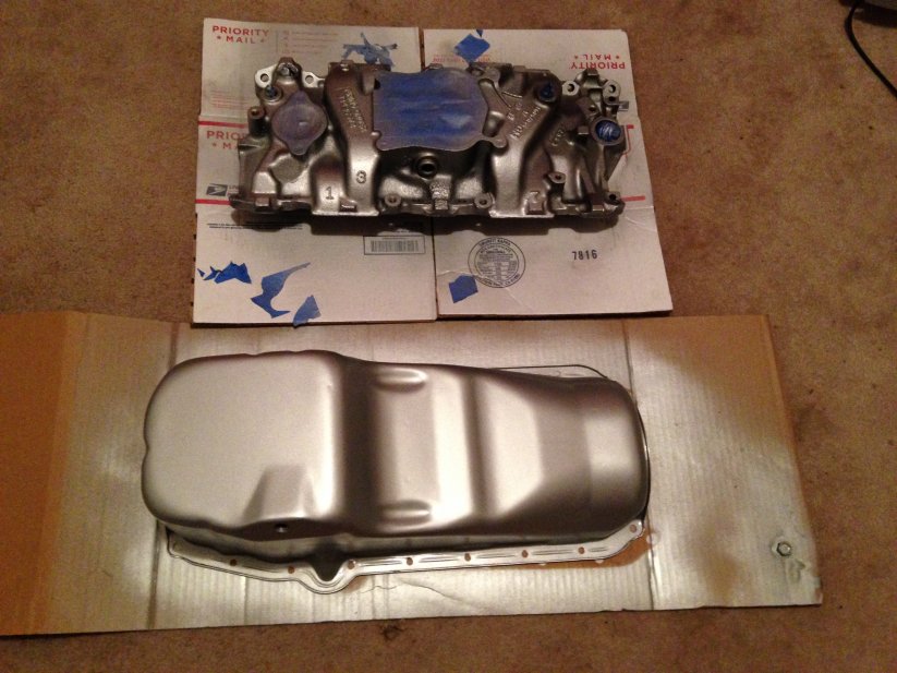

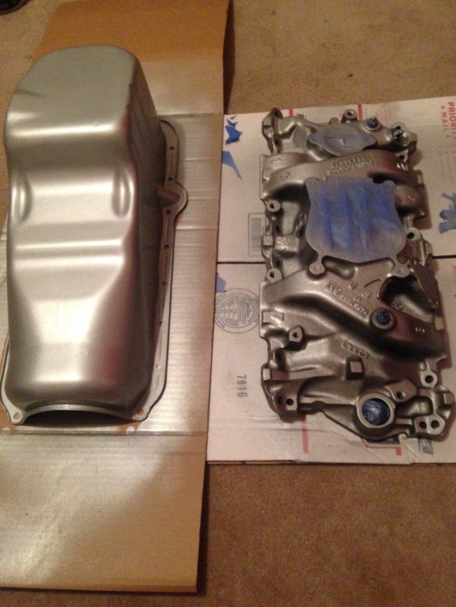

Bein an old engine there has been grime everywhere! first i degreased it with purple power degreaser, cleaned the rust and original coating with a wire wheel. Then i use Duplicolor prep spray to get any grease or rust left. Finally I used VHT aluminum engine enamel a few coats each then a good clear coat for a little shine, also VHT. So far I'm very please with the outcome. I will have more pics soon i have the block and heads painted black

Looks good. How many coats of VHT enamel did you put?
