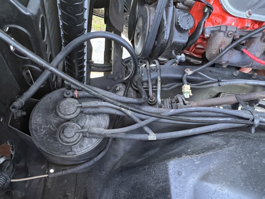

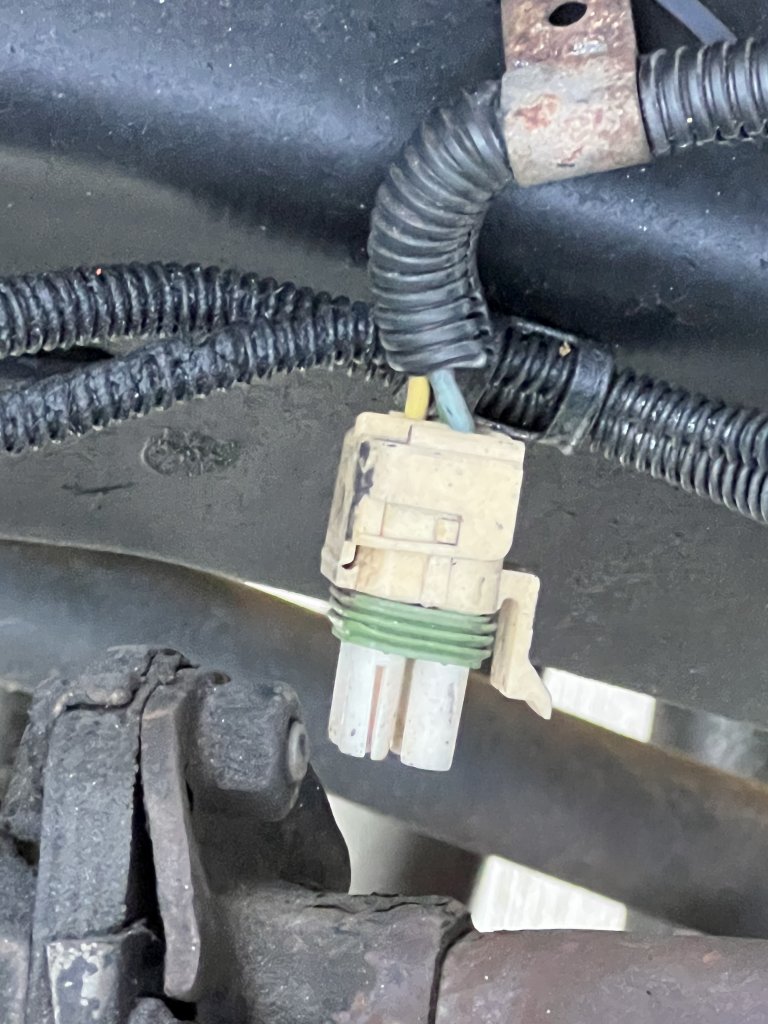

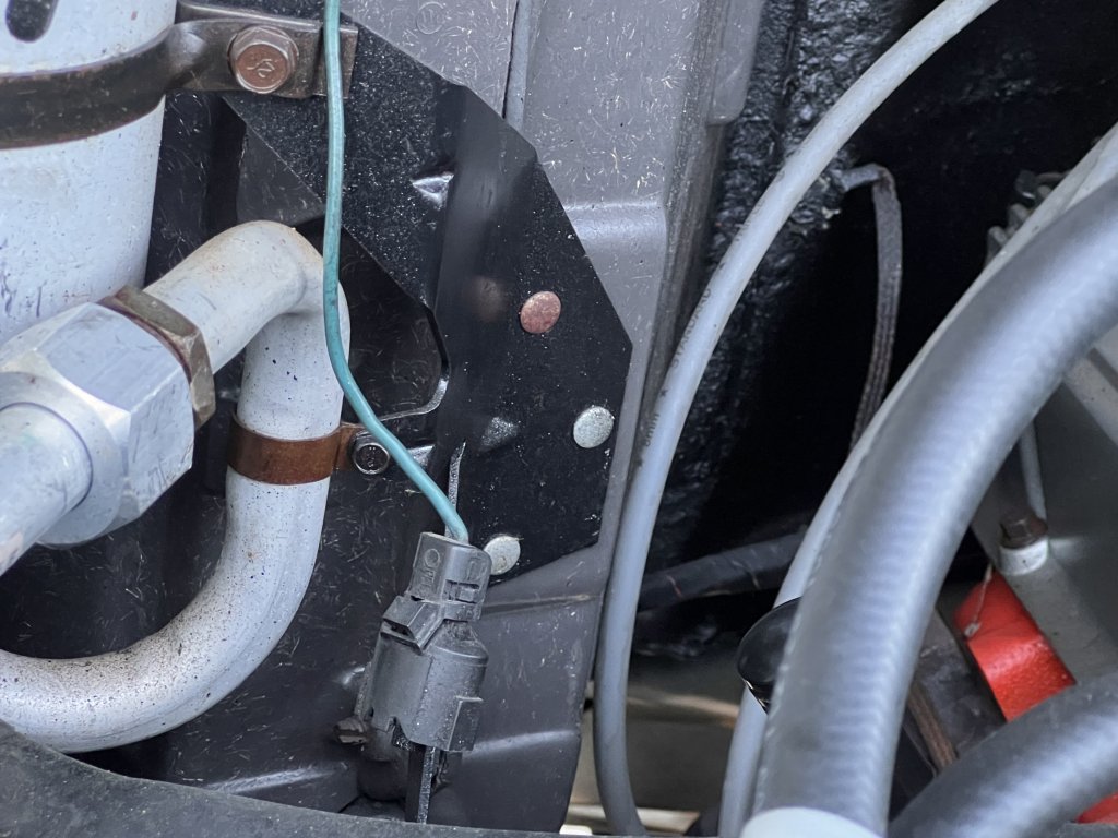

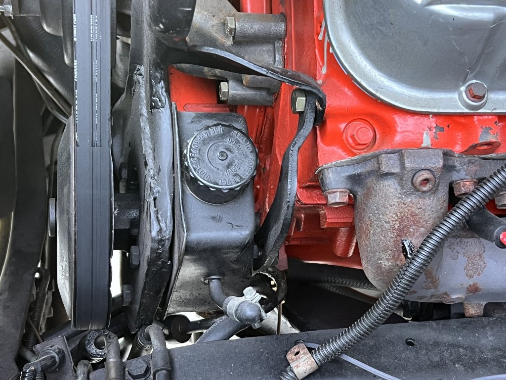

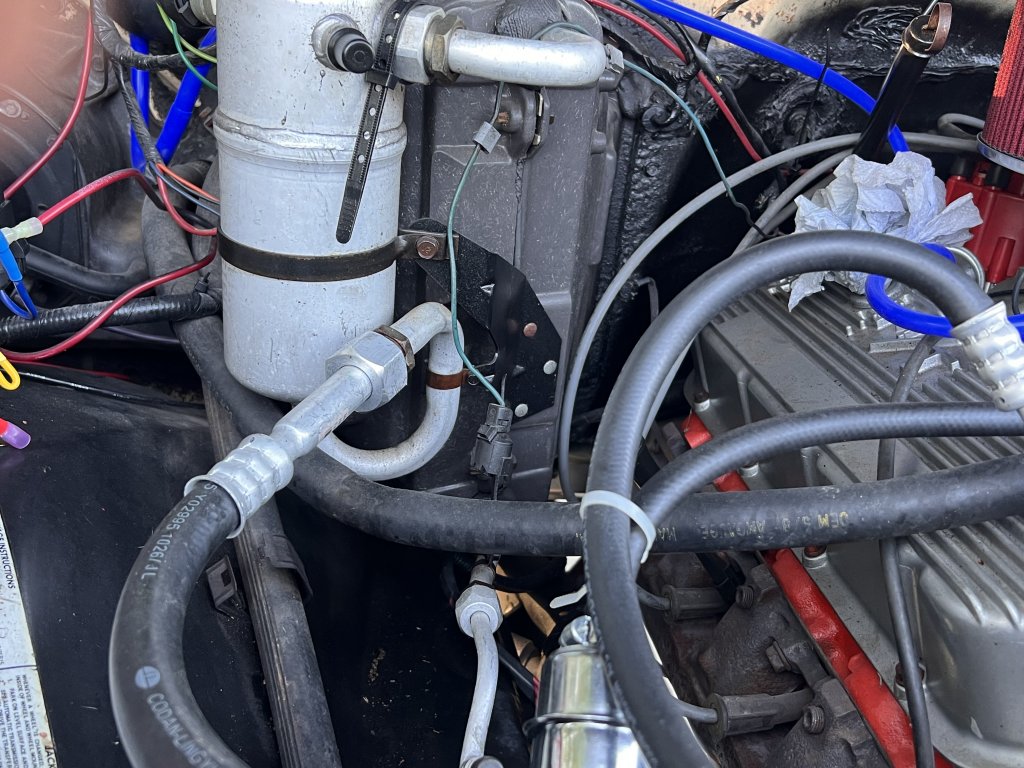

Trying to figure out what these artifacts are.
Bought a 83 k5 someone swapped a 454 into
The only thing electronic on the truck is the radio and it’s broken. There are a few random wires that I’m not useing and would just assume delete
There is also a weird solenoid on the firewall I cannot figure out
Carbon canister with an octopus worth of hoses not hooked to anything and a capped off line into the PS pump.
Any ideas advice very appreciated
I want to clean out anything I don’t need

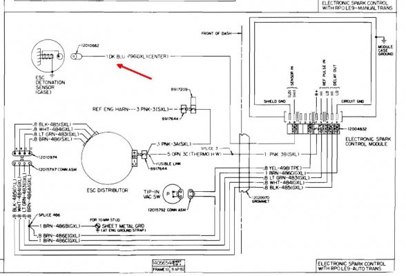

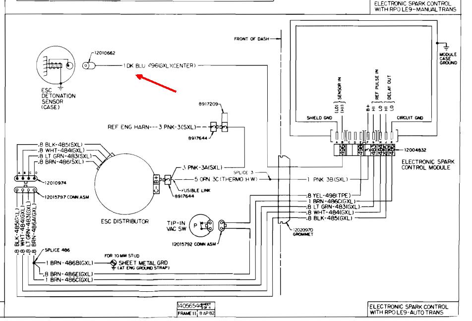

First image- looks like knock/ detonation sensor

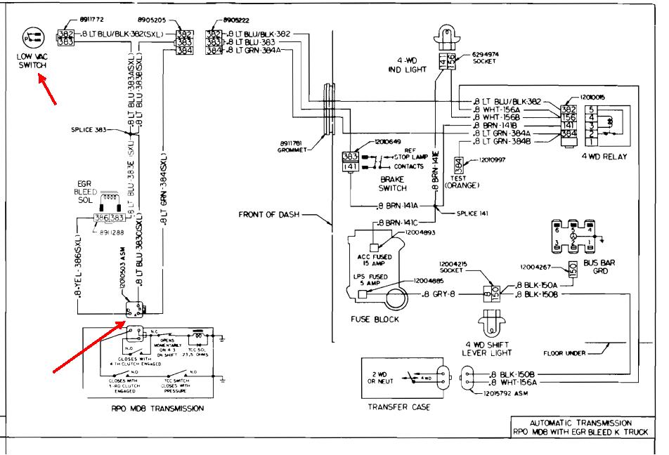

last image-probably plugs in transmission for TTC
maybe the weird solenoid is the low vac switch for transmission TTC

Thank you
Think I need that stuff:)
Best I can tell there are no wires connected to the engine/tranny and the only vacuum lines goto the breaks and hvac
