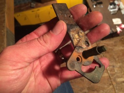

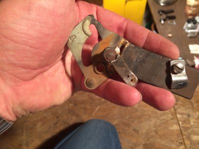

If you are considering changing to a different setup why not attempt to fix what you have first? I went and looked in my carb box and found my manual choke conversion bracket that I made years ago. It worked well for me but I went a different route with the truck it was on.
Heres one pic

And the second pic. I also found two Q-jets I forgot I had. BONUS!

I am holding it upside down in the first pic. The bar wih the cable clamp whent to the back of the engine and the lever arm pointed down. I was able to use the high idle cam and the pull off with this as well. It really worked good!
