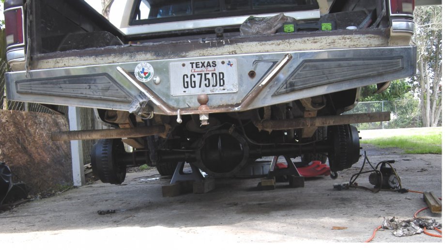

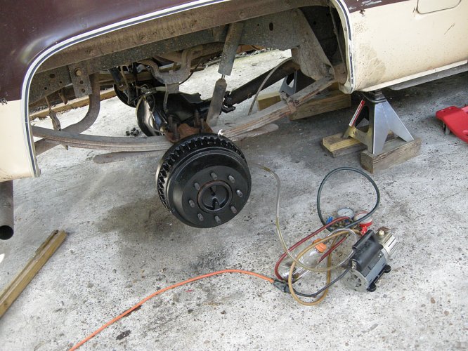

I am in process of upgrading my k10 pickup (was a 10 bolt, 3.08 ratio) to k20 3/4 ton. Got a front/rear from a 3/4 ton suburban; rear is 14 bolt, 9.5 ring gear, geared 3.42, semi-floater. I installed a G80 gov-lock in it, cost was $100 for that.
The rear axle installation was drop dead simple, no issues at all, did it in one day by myself. Kept the axle light during the install by waiting to re-install the axle shafts and drums till after I got er moved into position and bolted up. This install did not require a conversion U-joint; was able to use the same U-joint and driveshaft without any mods at all.
New rear axle is running sweet, though the Eaton G-80 is not real popular with the hard-core rock crawling crowd, my G-80 is working perfecting at present. I will not be dogging this truck, expect the G-80 will provide several years of service for me. (I kept my "open differential" and have it ready if needed.)
Am in process of replacing the ball joints on the front axle so that I can get it installed and have the gear ratios matching so 4x4 can be used once again.
