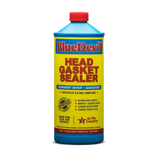

If that's the case: Part Number: 19540155. :popcorn:
