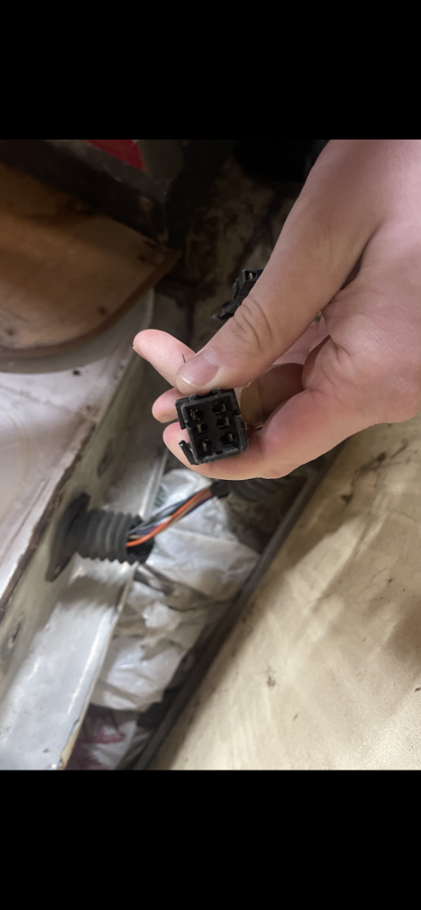

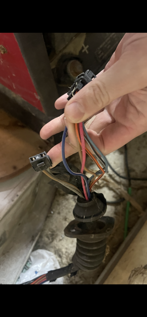

Yeah I think im just going to make it. Bought some wire loom and I work as an electrician so wire ain’t a problem. I put 2 pictures of what I have on my phone already down below. What about the lock connectors? Im about 30 mins south of Rockford. Thanks

Looks like your 85 connectors are different from what I have.
