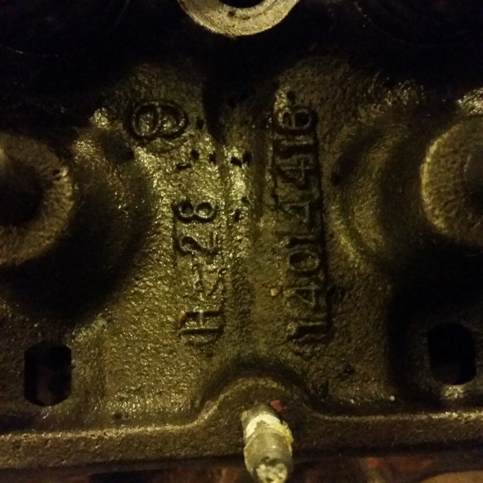

You could post a picture of the casting marks on the end of the heads. Typical heads have typical patterns.

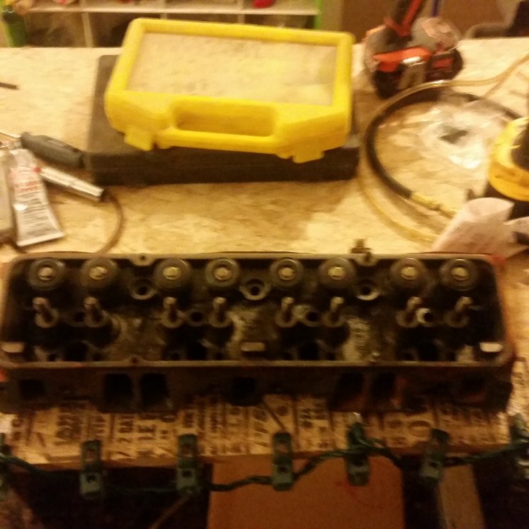

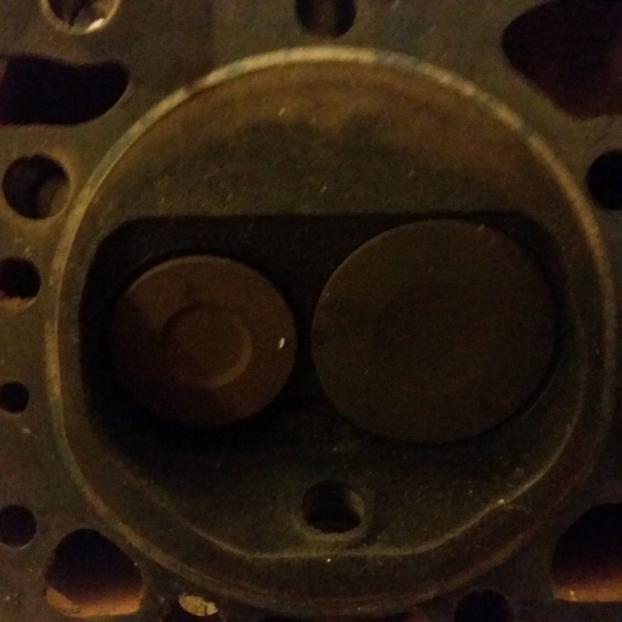

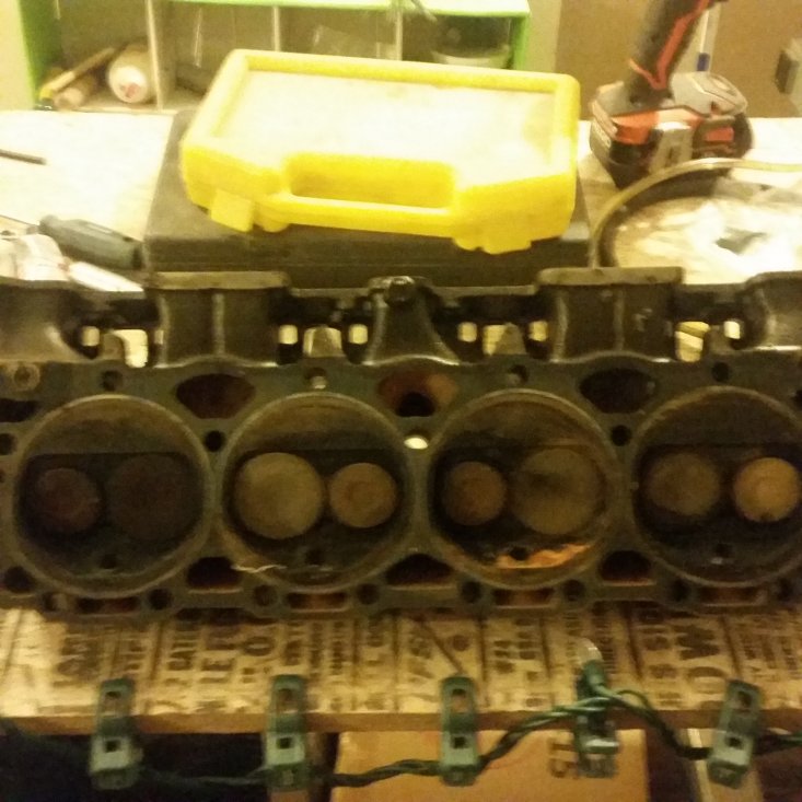

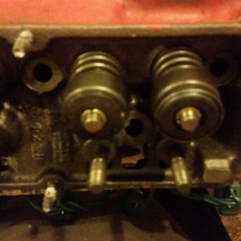

Thanks so much for the info guys. I think I'm going to give it a try. Got to do a compression test and make sure the heads are straight before I know for sure. But I took a quick look at them this morning and it looks like they may have put new valves in when they did the springs. I'll try to snap a couple pictures for you guys tonight. Glad I finally decided to join this forum. Been trying to find this info for a truck application for a couple months now .

Thanks for the info. I'm just looking to use what I already have but here some pics of the 416 heads
