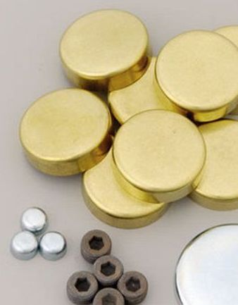

That's what I was trying to think of. I've seen to many engine blocks tore down now and even though I have a photographic memory on some things, I don't remember which is which, but IIRC, there's engines that have plugs like that behind the timing cover, and also in the back of the block over the cam plug, but I don't think it's SBC, which I've seen the most of. I'm wanting to say it's Olds or Pontiac that has those.
47,114
9,266
See the 3 small silver plugs.

Small blocks don't usually have the three in the back of the block those are usually threaded but I'm 99% sure all small blocks have the plug that you have to remove the threaded plug near the intake surface to access the knockout plug in that oil gallery passage. That's the only one that would go to the oil pan.
I'm 99% sure because when I started working at my uncles shop he always "yelled" at me for forgetting to hammer that damn plug out:rotflmao: Or maybe I'm just crazy? Haha
