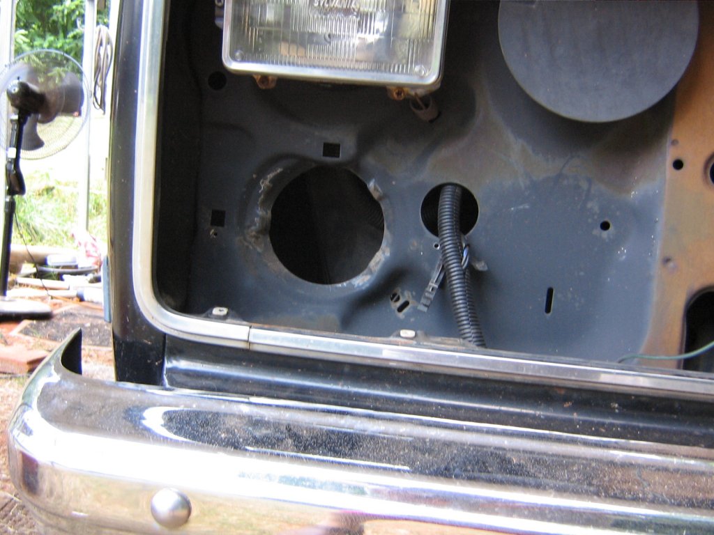

can't find parking lights to fit my 1987 R10 square body. Any help would be appreciated Bought the truck with no lights. I took picture

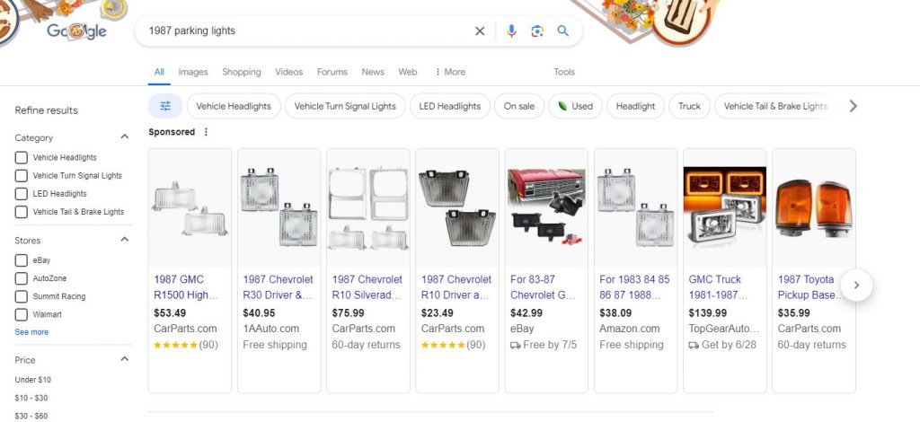

Welcome. Google search took .000008 seconds.

found all those. now I need to witch ones fit those mounting holes
Ya they’re readily available and cheap. Either style.
But looks like your truck and core support is the 4 headlight style?
So if I’m not mistaken all years of the stacked headlights, the running lights mount to backside of the grille.

Looks like you've got the smaller 4x6 light. If that's the case, you need another 4x6 light below it, not a marker. The upper lights are low beam, lowers are high beam. Your truck should look like the GMC above^. Then the marker light mount into the grille, there's tabs on the bottom side the marker light slides into and studs up top that it bolts in with a speed nut
This is a single light grille that's been crudely converted to a dual headlight but you get the point, that's where the marker light goes

tanks . This makes a lot more sense than what I could figure out
