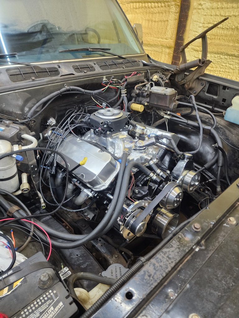

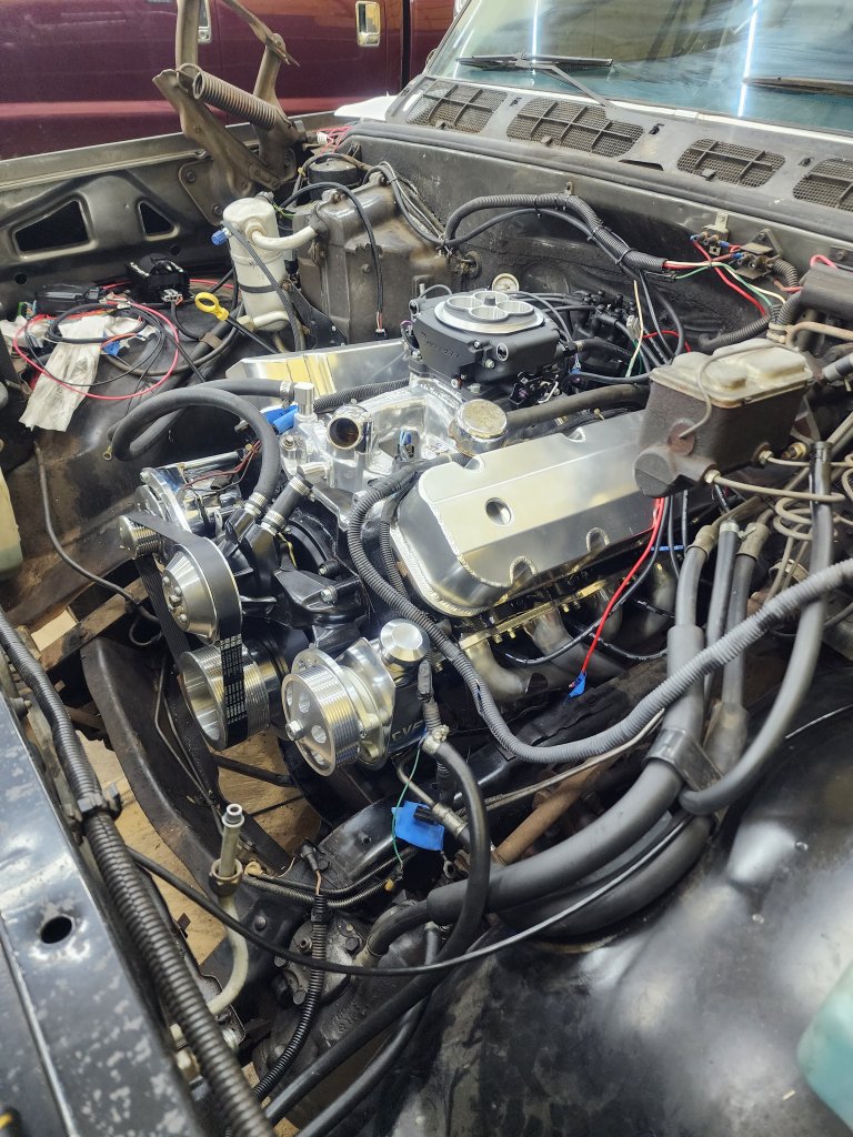

Came across this 1980 C35 454 4spd with Gear venders OD and only 6780 original miles. No rust, 7 original bias ply tires. Clean interior and spotless bed. It wiped the exhaust lobe on #8 so I took original Gen 4 454 out and dropped in a Gen VI I had built for another truck. Comp Cams XR276HR roller cam, springs, Edelbrock RPM Air Gap and Holley Sniper EFI with Hyperspark distributer, Ignition module and Coil. No fuel boss on Gen VI so I dropped 2 Holley in tank electric fuel pumps in with no return. Wish me luck
