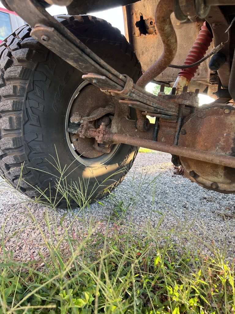

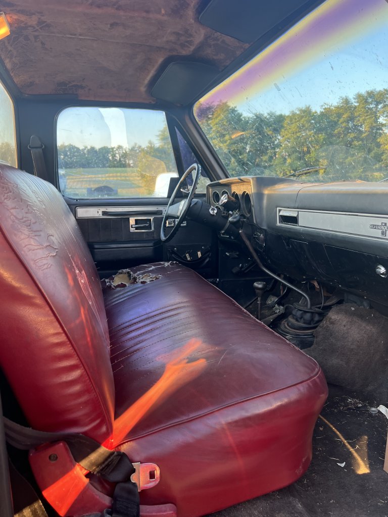

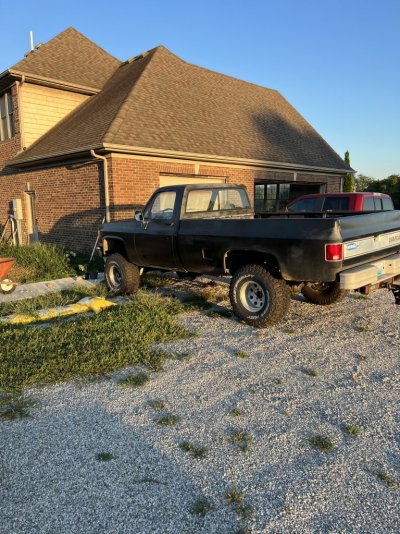

Hey guys, just bought my 1st sq body 2 weeks ago, for my daughter, and learning it was somebody else’s project. The cab is an 87 r10 but sits on a 4x4 frame. I do know the transfer case is a np205 from a 78. My question is is there a way to determine what year steering components I have? I need to replace some stuff underneath and noticed on LMC they have steering parts for 76-80 or 81-87. Don’t know which to buy or if it’s that big of difference.

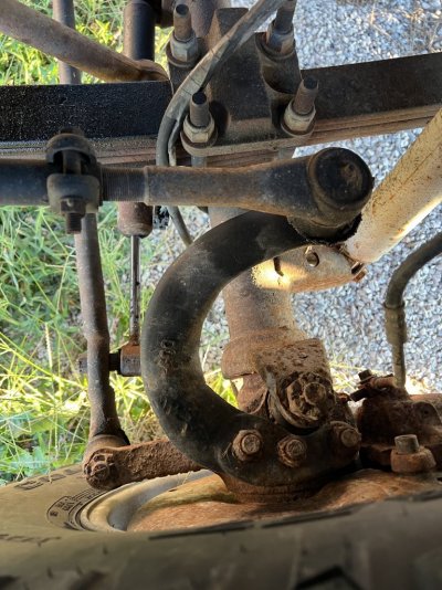

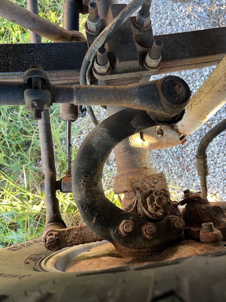

Pics of the steering linkage will help......along more pics of your truck

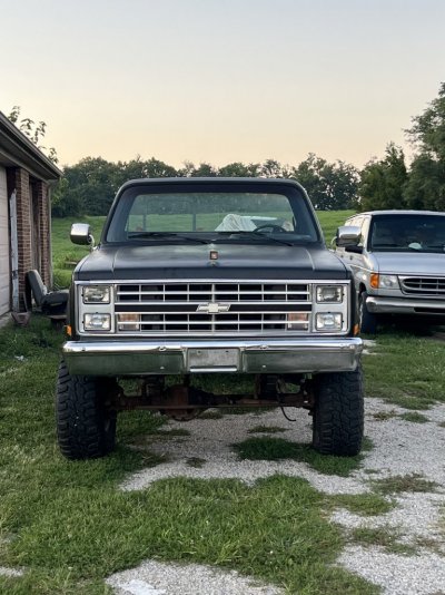

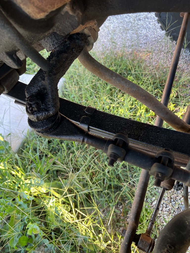

The aforementioned "76-80" perhaps refers to a Dana 44 front axle.
Though I was sure chevrolet stopped using a Dana 44 for a front axle right about 1978-1979
Where they say "81-87" they're referring to a 28 spline corporate 10 bolt axle. Which again, seems more like 79-80 all the way to 87.
8.5 ring gear.

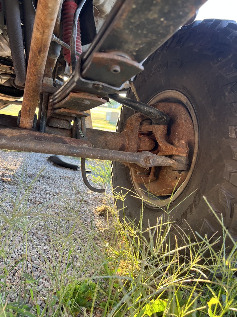

In your pictures, I can clearly see its a corporate 10 bolt, 8.5
So the aforementioned "81-87" front axle parts is what you need
For viewers wondering why I didn't say 88-91 in the k5 and burb.....
Those years were the 30 spline corporate 10 bolt (front or rear)
Vbb199
B-rate Hillbilly Customs
Jan 12, 2018
9,269
15,824
Salisbury NC
Vince
89, 79
89 Suburban R1500, 79 C10
350, 502
Also I don't think it really even matters besides the physical steering arm and knuckle itself between a d44 and 10b, maybe outer hubs? You mentioned steering parts tho, so... stick with the 81-87 stuff advertised.
