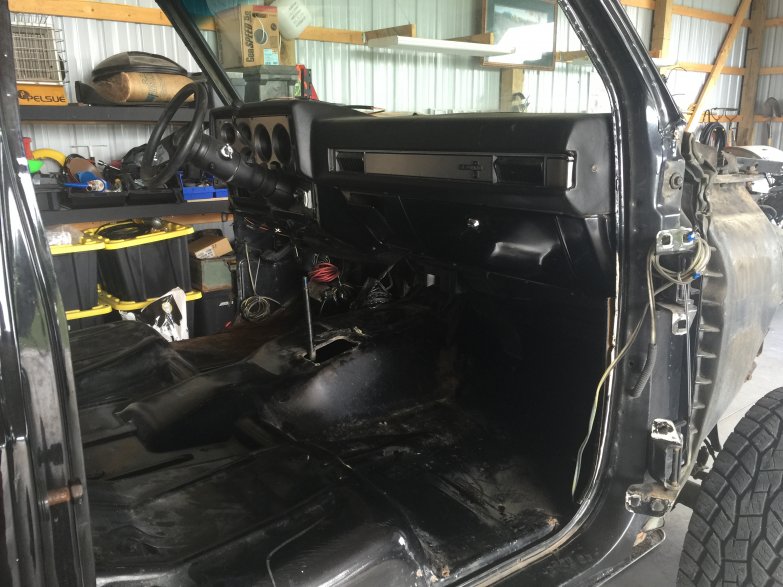

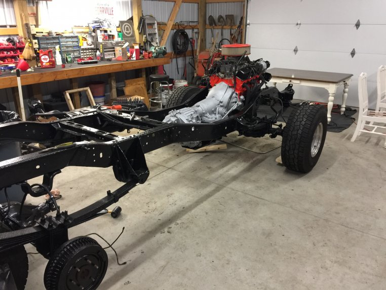

My name's Austin and I'm new to this forum. I'm in the process of fixing rust and restoring my 1986 k10. I've got a couple questions to ask and a few pictures to post of where I'm at in the whole process. I sandblasted the frame with a blaster I bought from HF and hand painted it with KBS Rust Seal, removed the engine and painted it, swapped the th350 for a 700R4 and NP208 that I had in the shop for the extra gear.

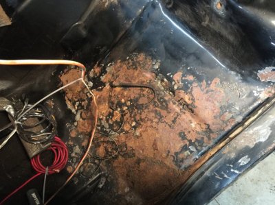

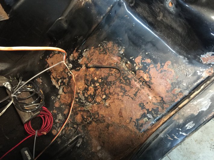

1. In the picture with my cab floor, should this be replaced or do you think it will stop spreading if I sand as much of it out as I can and use some type of rust stopper and paint it with the same Rust Seal as the frame?

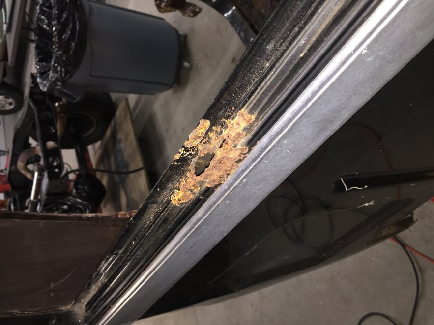

2. I removed the rear window and found the rust on the bottom edge. What's the best way with going about this?

Floor rust looks cleanable if it is not all the way theough. Window edge would need to be fixed with either donor sheet metal or just cut/bent to fit pieces.
