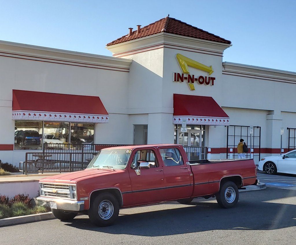

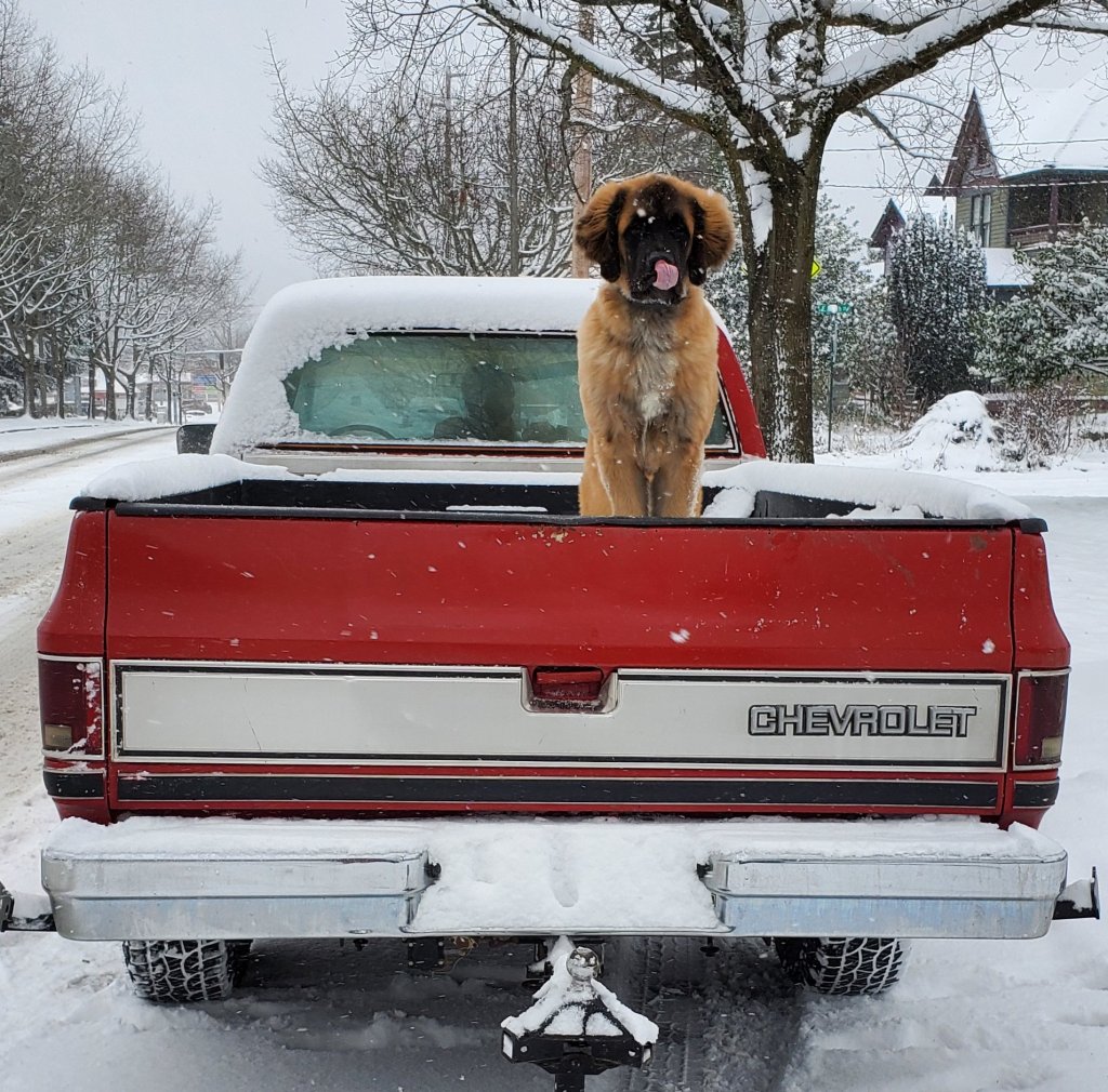

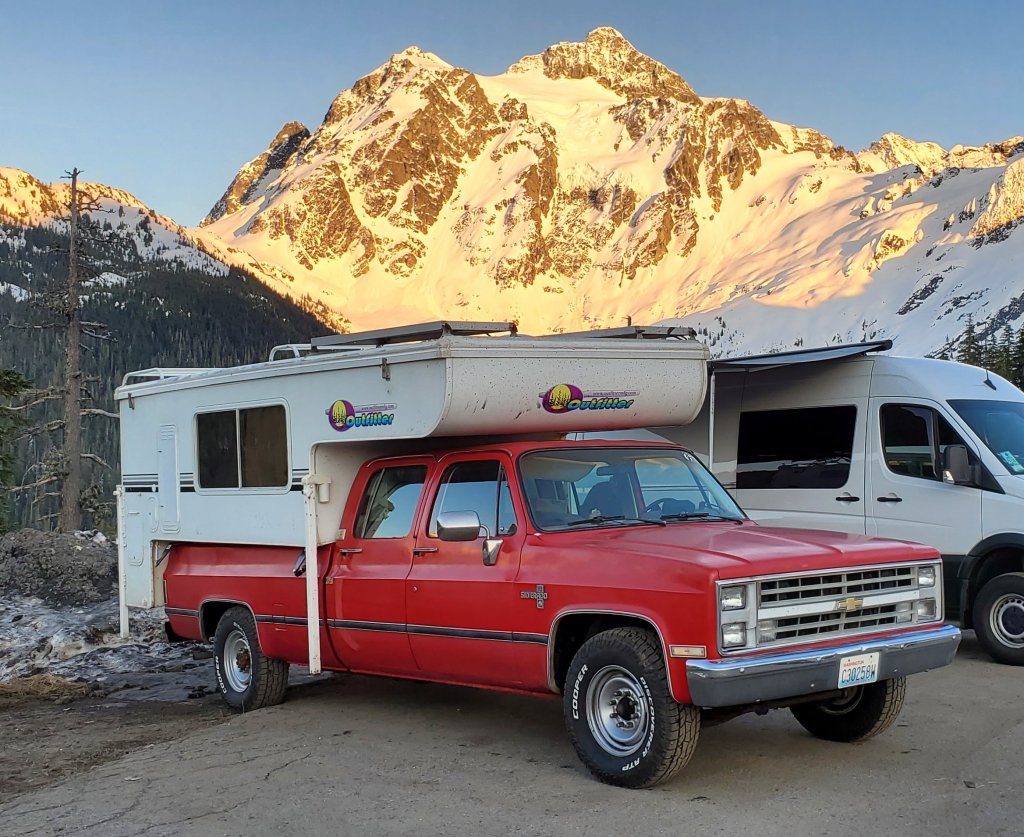

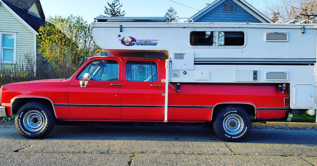

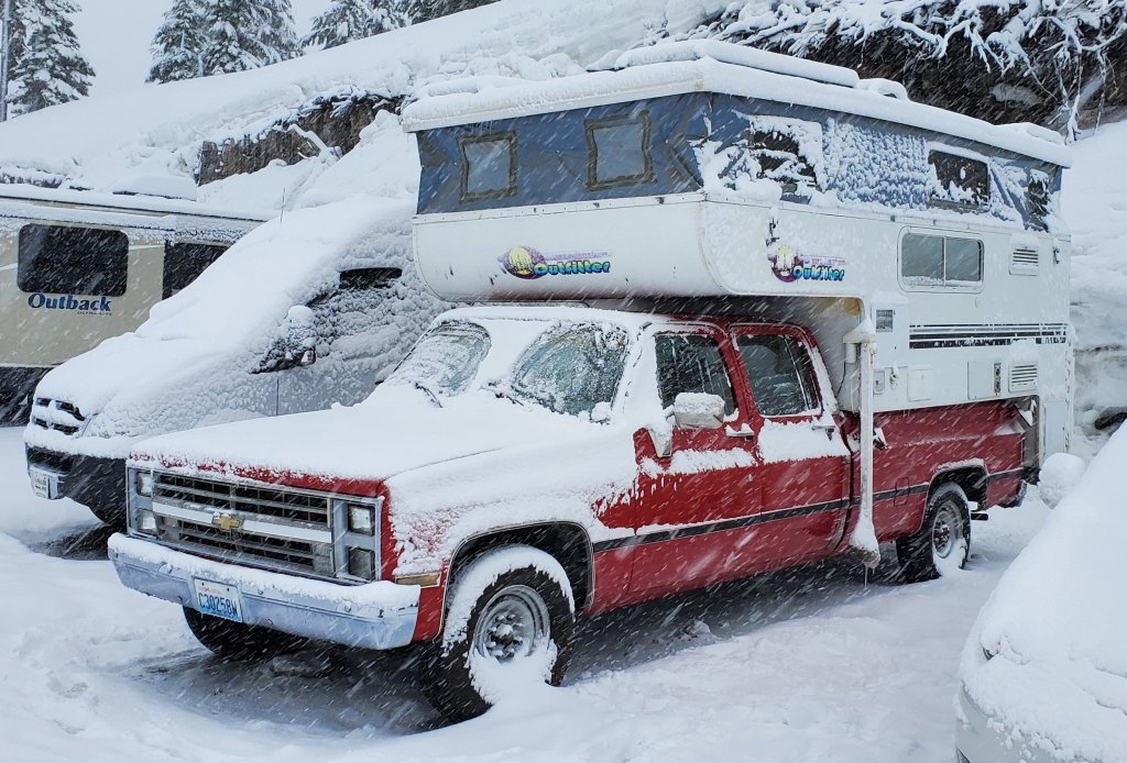

Hey all,
I'm a new member. I have owned my 1985 C30 3+3 Silverado since March 2021. Found her online, fell in love, flew to LA, drove to the top of the NW with no problems besides a flat in Crapremento. It carries my camper in the winter and hauls our travel trailer and 3 boys in the summer. I replace parts as needed with US made, or at least not Chinese. I have replaced u-joints/carrier bearing, alternator, starter, battery with all new wires. Last week I ordered headers, intake and carburetor. Pulling our trailer to go camping last Friday I lost compression at 55 and the truck would not restart. Towed to mechanic and he reports that a scope of cylinder 1 shows a dinged piston and bent valve. He believes the timing got off bad enough that pistons and cylinders collided. I didn't know that was possible but he says 454's are interference engines. A second opinion mechanic doesn't think that is what happened, he thinks it more likely that a valve got stuck on build up and the slammed into the cylinder.
Needless to say I have to fix this one way or another. I love learning to work on this truck but some of the work required here may be beyond my capabilities with the tools I own. However I do love an opportunity to buy more tools, like say an engine hoist.
Tell me what you would do I you were keeping this truck for my purposes and wanted to pass it on to your children. Ideas I have pondered, fix the valve train and heads, possibly pistons but then can the bottom end handle the new compression for much longer. Buy a used or rebuilt 454 off craigslist and learn to drop it in myself? Or go for a reman long block from S&J or someone else and have a mechanic do the work for the 7 year warranty.
Thanks for your replies, please assume I know very little about these things,
